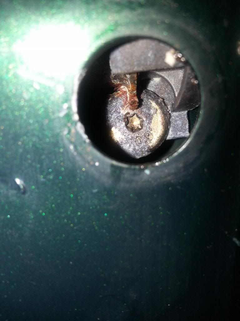

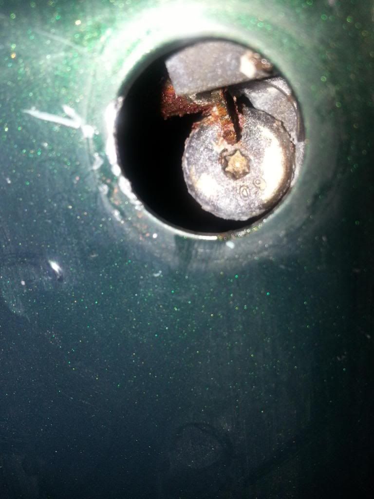

According to the previous owner, he never locked his door supposedly only relying on the remote locking. I figured the issue then could be with the lock cylinders (tumblers?). I exposed the hole on the side of the door leading to the door lock cylinder screw and tried turning it. IMPOSSIBLE. It looks and feels rusted tight.

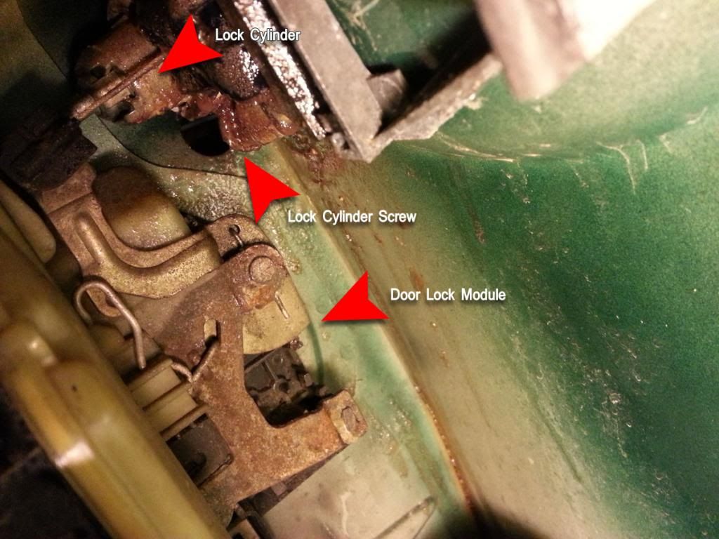

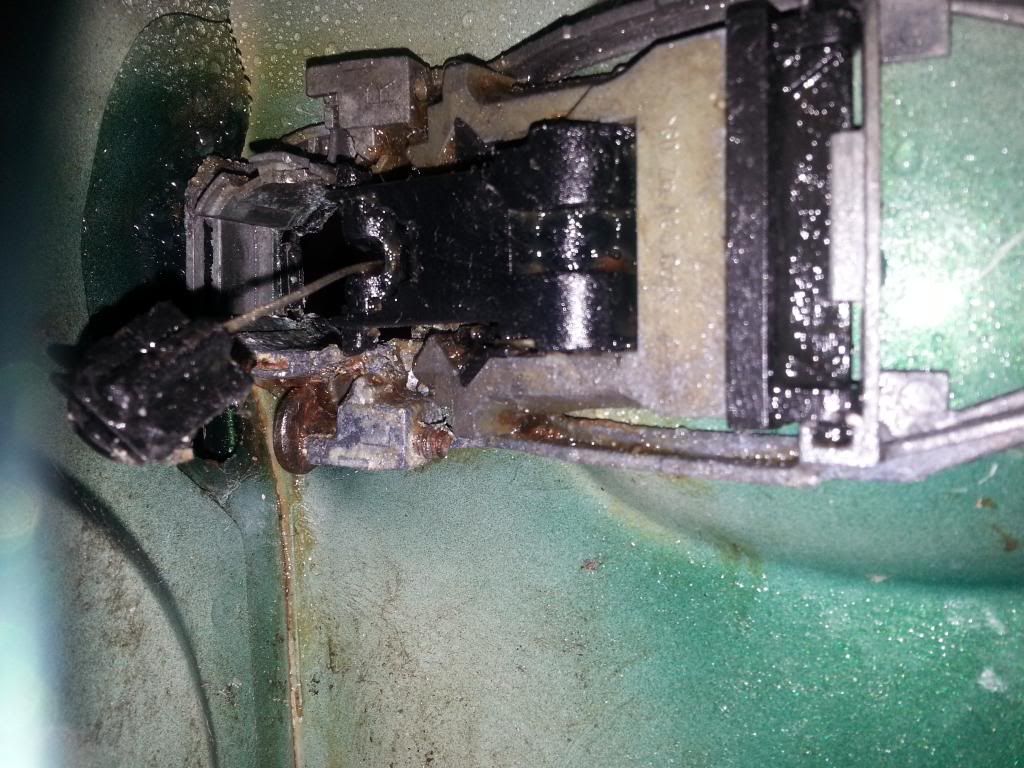

I then removed the inner door panel and metal frame to expose the backside of the screw. You can see it in the following photo:
I still cant get a decent bite in that screw. CAN SOMEONE PLEASE tell me a way to get the door lock cylinder out? My understanding is the screw must loosen. From the above photo i can try to work the apparatus which the screw turns but i'm unsure how it operates back here.

#2 ·
That looks terrifying, and I'm wondering how the hell it even began to look like that. The only thing I can think of is putting the torx bit on a 3/8" ratchet and gradually increase the torque to loosen the screw until it cracks loose. Once it cracks, use a hand tool. Just make sure the bit is in there good enough to not strip out the screw. It'll become exponentially harder than.
The only thing you're trying to achieve to remove the lock cylinder, in order to remove the lock module, is to get the cable off the exterior door handle.
#6 ·
I would suggest that you give it a good squirt a few times over a day or two, with a good penetrating oil or WD40.
Then put a torx bit in the screw and give it a few wacks with a small hammer, being careful not to break anything. And then try to undo it.
Very good suggestions.
I did try spraying with penetrating oil for a few days and still no budge. The dremel solution sounds interesting but somehow getting thru the access hole with the correct head could be a challenge. Researching.. I did purchase a screw extractor tho.

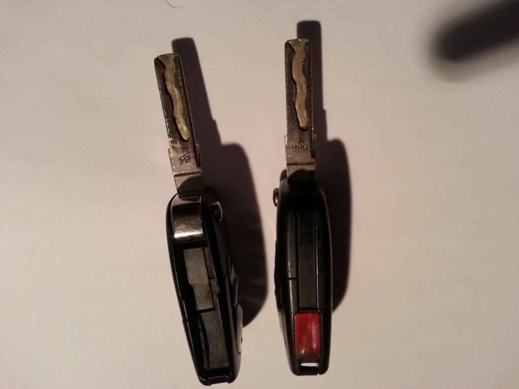

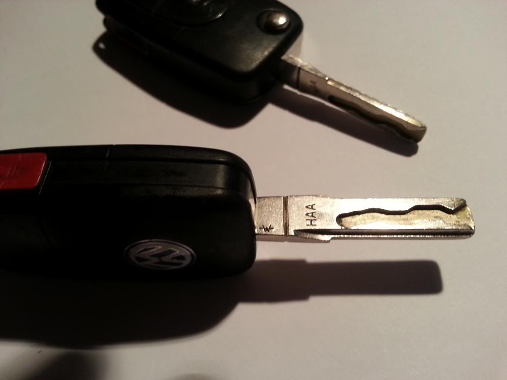

Here is a snapshot of the 2 keys. Again they ONLY work in the ignition and glove box. I notice the keys dont enter the respective slots completely (i would expect all the way to base MINUS 5mm) but the cylinders turn so i guess it is by design. For both keys there is an inscribed "W" with a strikthru on the silver at the base near the black area.

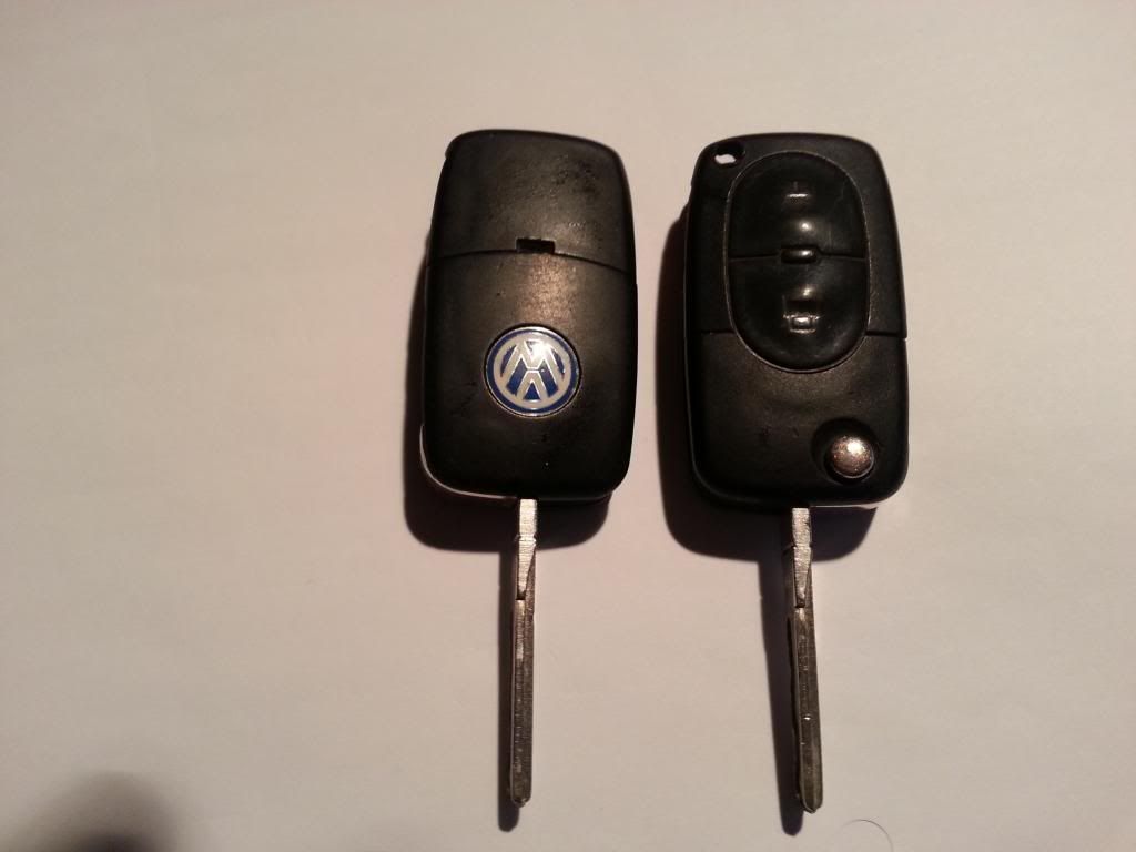

Those keys appear to be fine. When the key is inserted in the door lock or ign, there should be about 5-7mm between the lock and key body.
What do you mean ? "they ONLY work in the ignition and glove box. ....but the cylinders turn"

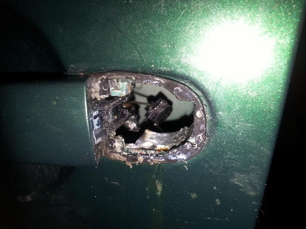

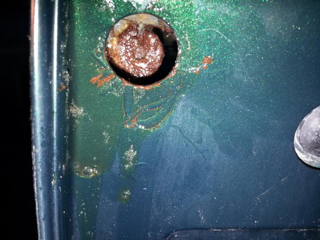

#11 ·
I took a snapshot of the passenger door lock cylinder screw thru the door access hole. Do you see that piece coming from the top which appears to touch the front of the screw, is that normal? Is it possible these lock cylinders have been welded in place or are some kind of dummy locks?
#12 ·
Except for the corrosion, yes.
Not at all likely.
For the record do i turn the door lock cylinder screw "counter-clockwise" to unscrew it out in order to release the cylinder?
Yes. (It is NOT a left hand thread)
Normally you loosen it just enough to release the cylinder, but in your case, I expect you will be replacing those parts anyway.

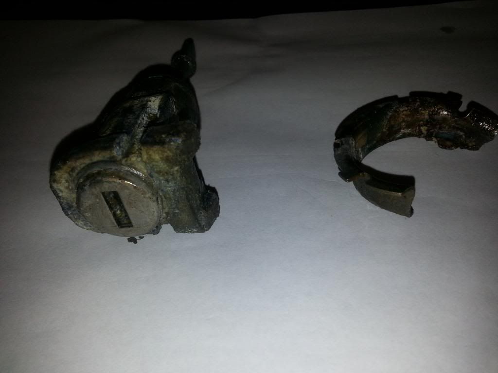

#13 ·
I finally got the door lock cylinder out but we had to break a piece to release it. See photos. We still were unable to get the screw out the normal way. When i look at everything i'm not so sure what is salvageable. For now i'm going to soak the door lock cylinder in some Coke to see if it loosens up the cylinder so that i can actually insert the key into the lock. As for the broken piece i'm going to explore replacing the entire assembly which the piece broke off from (which will include the door lock cylinder screw) to resolve this matter. If you have a better suggestion pls chime in
Can someone tell me the name of this part below -- it is located on the inside of the driver's door directly inline with the exterior door handle. I have no clue on how it is fixed in place. It holds the lock cylinder screw and so I'm considering replacing the whole assembly to resolve this corrosion issue...
