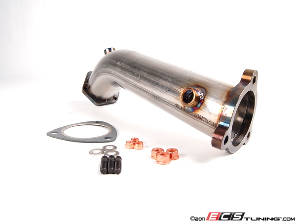

#17 ·
Seriously ECS?
The OP has given no indication that this is a track car. Can you at least pretend to acknowledge in the post that installing the pictured product on a road car is illegal? And that he'll fail emissions testing in his home state if he installs that thing? I don't expect you to point out the minimal performance gains (of both this and the other mods you mentioned), but the drawbacks of this one go far beyond that.
#16 ·
What gains can you get with that cat delete?
Sent from AutoGuide.com Free App
Little to none. Even the stock cat is pretty free-flowing. In addition, this is illegal in all 50 states, assuming this isn't a track car. Not to mention the fact it creates all sorts of issues if you ever try to sell the car (at the least, you MUST disclose the modification to the buyer; the sale can often be voided if you fail to do so.) And the OP is in Oregon, who will certainly notice this when he goes in for emissions testing.
