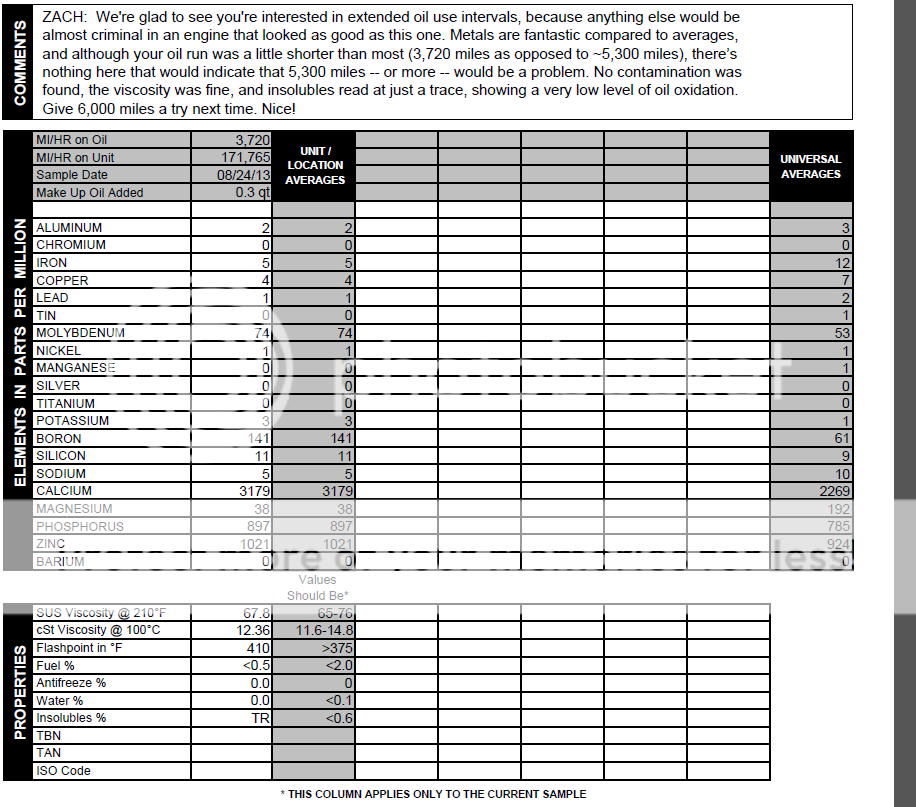

Sent some oil from my last change into blackstone. Finally got the results back today. The sample was from oil right after installing my external oil cooler. Put almost 4k miles on the sample.
Details on my car:
172k miles
Orig turbo, engine
External front mounted oil cooler
1.8T AWM, driven daily. My daily commute is about 10 miles highway at ~80-90mph and 4 miles residential.
