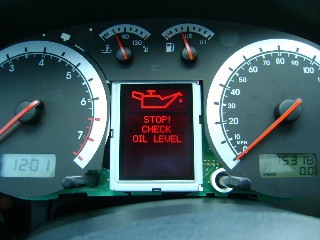

I've been starting my car with the windows closed so I assumed, but this weekend it was warm. When I started the car with the windows opened I heard the clatter from the engine. It went back to a normal sound with very little clatter in a few seconds. When I checked the oil there was none I could see on the stick. I brought it to Quicklube and changed the oil. They said there was about 2 quarts that drained. I don't normally check the oil just change it every 4000 miles. I hope I haven't damaged anything, but I'm wondering if anyone knows when the low oil indicator comes on. I'll bring it to my machanic to check for a leak, unless the car is using it but I don't see any smoke.

I think some European/UK Passats had a low oil indicator but US spec ones didn't.

yea, my may 29'th of 2001 b5.5 has an oil level sensor as well. it's good stuff to have as it's actually saved my butt.
my car tends to run through about 2.5 or so quarts every 3k miles. this is likely because i drive the car hard-ish while it's still not fully warmed up (late for work in the mornings... :banghead: )
