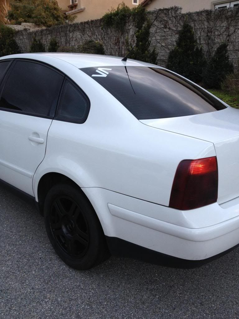

Here is my Passat. Needs some engine work, but tell me what you think about it. :)
1.8K views 18 replies 11 participants last post by  joeylardieri
I bought my passat in september of last year, absolutely love it despite some of the problems its having. Aside from that here is a picture, please let me know what you think about it.
well for starters, My instrument cluster is on the fritz, the little lcd doesn't even light up and doesn't display half the lights. ASR switch doest work, theres an oil leak somewhere because theres oil where the spark plugs should be. both front cv axels are clicking, LOUDLY. :mad: Dont get me wrong. I love the car to death, but i dont have the money to repair any of these at the moment, so im hoping the car doesn't one day explode. Ill get some more pics of it later!
