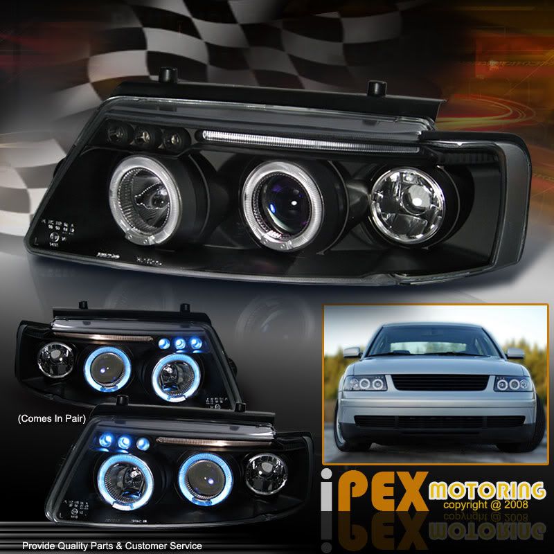

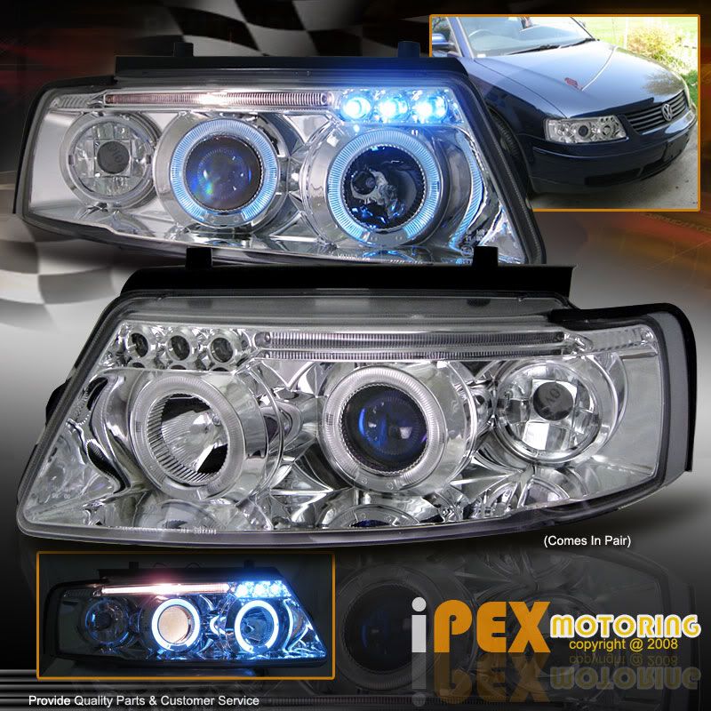

My headlights are getting to the point to where they're cuting down my vision at night quiet significantly. I believe they're to far gone to be refurbished. Searching a little bit I find you can get stock replacment ones for around $114 each, then there are the Angel Eyes for around $300 for the pair, and then they are the Eagle eyes for around $165. Are the eagle eyes junk or has anyone used or tried them before. Any input would be greatly appreciated. Or am I just getting confused about the angel eyes and eagle eyes?
I like #1 too but just to warn you that is the same cast design as my one peice S5 style headlights you have to take the front bumper off the car to get them in, you also have to pull the two little bolts that are screwed into your stock headlights and install it on these lights. PM me if you don't know what I mean, I also have a set of stock headlights that are in great condition although with the shipping not sure if you would save or not.
I have No. 3 on my '00 black B5 and I like them - not sure I would with a different paint color. As with most things, personal preference.
I did not have to take off the front bumper cover to install mine. There are the two screws on top, plus one you get to by removing the corner light. You'll have to splice some wires to power up the halos and LED's.

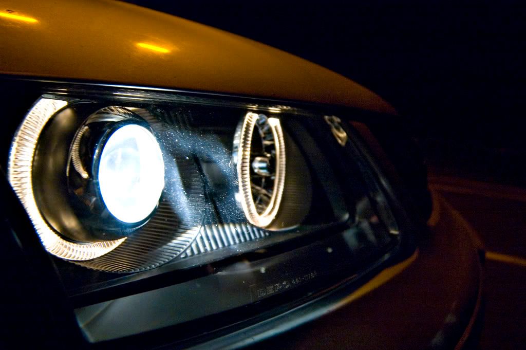

here is another otion for you but these are a the type of headlights that people either hate or the love! I Love them!!!!
alot of people say they belong on a honda civic, which I dont understand, cause we are keeping the S5 style headlights in the same family!!!:D:thumbup:
