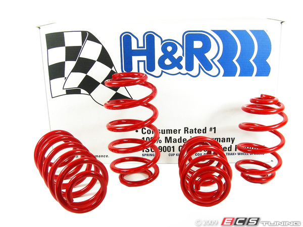

Bilstein HD shocks, H&R Sports springs are the most common drop with a daily driver feel. (1.5" drop)

I understand you want to go as cheap as possible; however, I have done that, and have gone through 5 different sets of suspension setups as well. You will literally kick yourself by "cheaping" out, and it will cost you MORE in the long run. The cheapest, BEST way is springs and shock combo (HR sport springs/koni yellows). Don't just to springs...you'll wear the stock shocks out faster and will have to replace them, effectively spending double for the same work of taking the suspension off. Spend the extra money and get the lowering shocks to match. If you're unsure about which height you want, spend the 799 and get ST coilovers which will let you adjust height.

I don't know your definition of cheap, but I'm currently running H&R Sport springs with Bilstein Sport shocks on my 2004 FWD sedan. It dropped about 2" all around, it's sitting at 13" from fender to center of wheel. It's low enough for me, and there are some speed bumps around me that I can scrape if not careful. Before this I had FK Streetlines, but sold those to a buddy here since I wanted something stiffer and didn't need to adjust height. I was fortunate enough that I didn't lose much money on the transaction, but I still did the work multiple times, and my times means something to me, so in my mind I should have gotten what I wanted the first time. I installed the coilovers, then swapped the stock back in, then later swapped my current set up on. A lot of work if you're not getting paid for it, but I was able to do it. Bottom line, figure out how low you want to go and find the best solution you can afford and begin saving and planning for it. You'll need some tools for the job unless you're paying someone else, then you need to budget for that as well.
To help, FK Streetlines I paid about $530 or something with delivery, for the H&R/Bilstein setup I think I paid about $700.
