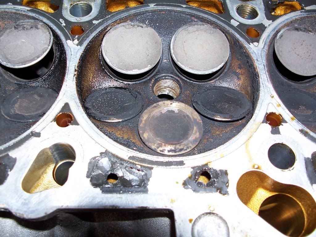

On a lighter note, I've been looking into my car with the failed timing belt. The tensioner held and the belt didn't break, but the belt stripped. Without pulling the head I looked around as much as I could and I can't see any damage visually. All 4 cylinders cycle with no noise or hindrance or anything. I'm trying not get excited but is there even physically any possible chance the piston did not hit a valve? It seems to me that no matter where in the cycle some valves had to be open somewhere during the timing belt failure.
$2600 is a good price for a cylinder head rebuild and all associated items, including a new TB kit and waterpump.
Potentially the Water pump siezed and stripped the teeth off the belt?
Turning the engine over by hand will not, by itself, confirm if the valves are damaged. A mechanic with a boroscope will be better able to tell, but history with this engine supports a high probability of valve to piston contact for your TB failure mode.
Most of time the timing belt does not break, but just its teeth stripped. I believe your tensioner roller or water pump froze up and stripped the teeth. When timing belt fails on an interference engine like Passat, some of the valves will always hit the pistons and bend. That’s why most car manufactures are now using timing chain instead of belt.
If you are turning the crank shaft and there's no timing belt, you are not moving the valve train. Since the pistons already bent the valves out of their way, you hear nothing. Just a possible explanation.
What happens when you turn the cam sprocket?
#16 ·
I haven't moved the valve train and I'm tearing into the VCG soon to do some further inspection, but if a valve hit a piston there would have to be some sort of mark on the piston right? All 4 pistons are clean. No marks, no scratches, no blemishes at all. I'm graduating today so life's been a little hectic, but with summer starting I'll know shortly the total damage. If I somehow aligned the planets and didn't have a piston to valve collision I'll be sure to let everyone know.
#17 ·
I hope everything works out for you, I really do. Did you remove the cylinder head and inspect the entire piston crown..?? If you are only looking down the sprak plug tunnel, then you are probably not seeing the area where the damage would be inflicted.
But you are correct, no marks on the piston would most likelt indicate no valve collision.
Dave. :)
#21 ·
Why rent a borescope. You have bent valves. The head has to come off no matter what. Yank the head.
Buy a timing belt Kit
Buy a head gasket kit
Buy some valves and guides
Take the head to a machine shop
Pay $150-$250 to have all the guides, bent valves and seals replaced as well as having the head checked, decked,cleaned and valves honed.
Then reassemble
The only real question is how many valves will you need and how bad the dings are on the pistons.
#24 ·
Okay Okay... I'll stop playing around with the idea that I may be the one and only lucky one to avoid a disaster. I'm going to pull my cylinder head. I think I was in denial about my valves being jacked but I can see through the cynical wisdom that is PassatWorld. Thanks vets for all the advice.
