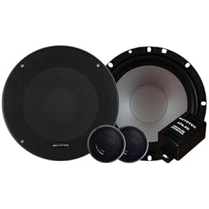

Ok, I checked. No monsoon amp. Just 4 blown woofers. So my next question is, what woofers can I replace them with?
Would something like this work? Is 4ohms correct for a non-monsoon system? I'm not looking to do any upgrade to a high-end system - just OEM-like replacements without the OEM price.
Here are a bunch more I found Will these work?
Do I need to just drill out the rivets and use either self-tapping screws or nuts+bolts?
