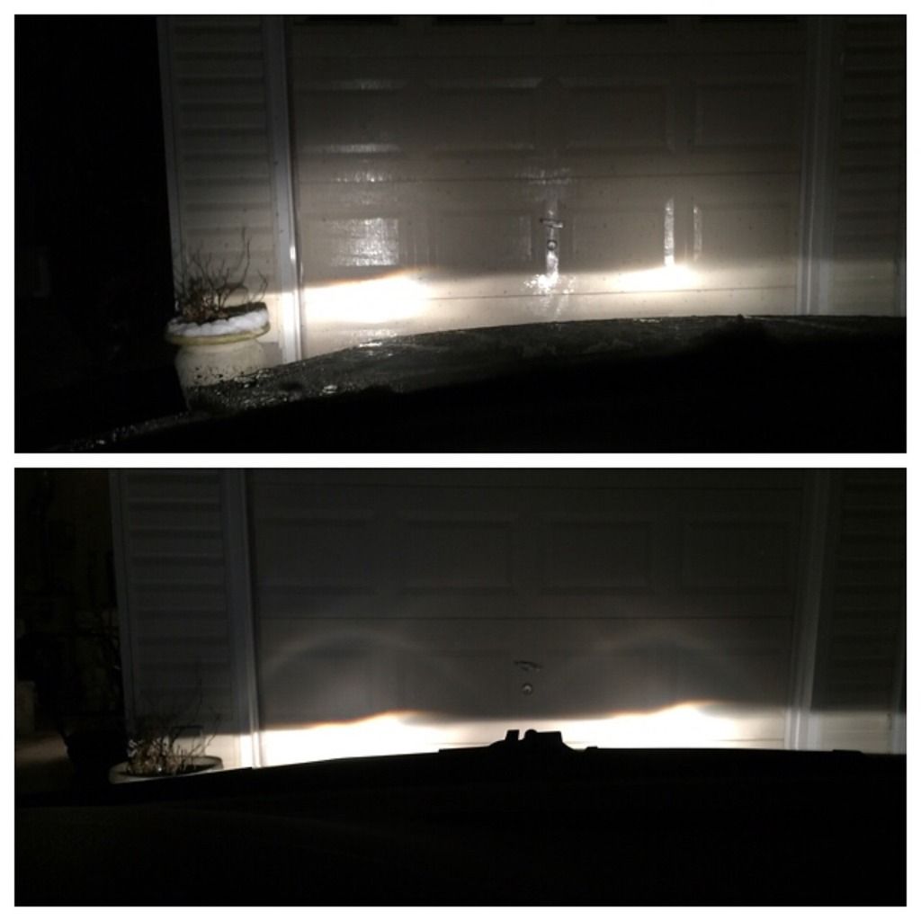

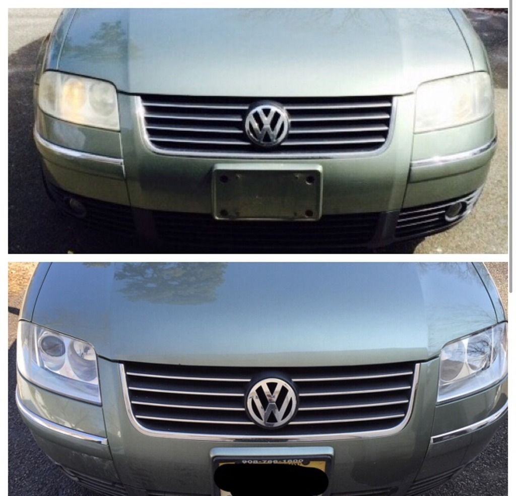

Sorry to get off topic but you did a hell of a job on the lights! what did you use?

Also, nice work on the headlights. I did mine, and they didnt come out that good. I was looking at replacments, and when I saw the price of the OEM Hellas, I changed my mind.
Maybe Ill try the 3m kit, instead of the Turtle kit.

Thanks!! The kit works really well!!! I got it at Walmart for 15 dollars?

I'm still stuck on how good those lights came out, I'm going to order a 3m kit right now!

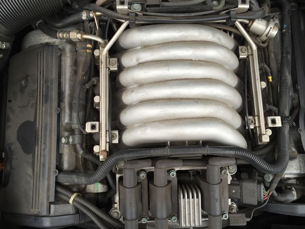

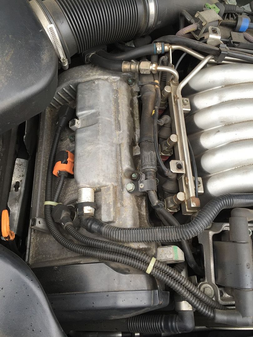

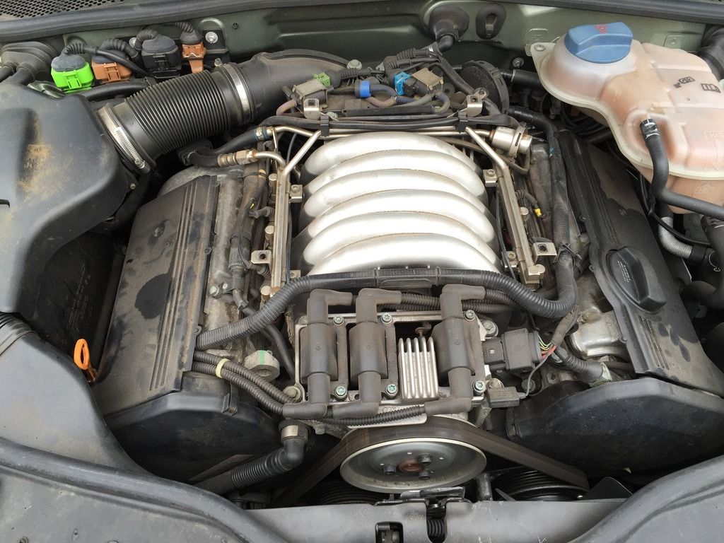

Mikey, open your hood and look at the part of the engine nearest to you. The black rubber belt you see is the serpentine belt. Immediately behind that belt and all the associated running gear is a black plastic cover clipped to the engine (one on each head). Unclip that, pull it back and see what's in there. Take a picture and post it here. If there is a chain in there, I'll buy you any non-alcoholic beverage of your choice, and mail it to you. No kidding, and no sarcasm. This exercise is designed to help you see for yourself. Take ownership of your car.
