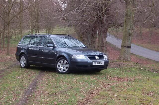

So after much looking, I found this:

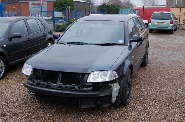

A Passat 1.8T Sport 150BHP, with one owner and only 36K on the clock. A bit of a gem TBH, and in a reasonably rare Blue Anthricite colour.

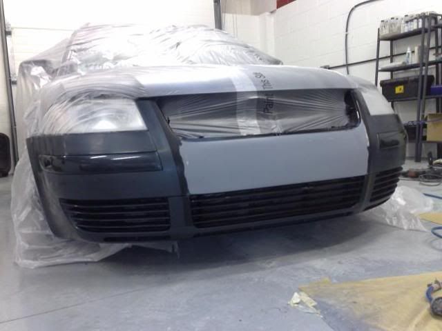

The black roof, pillars and bonnet section worked really well, and after 3 attempts, I got the front bumper two tone efect looking how I wanted it. I also colour coded all my strips, lower aprons and side skirts.

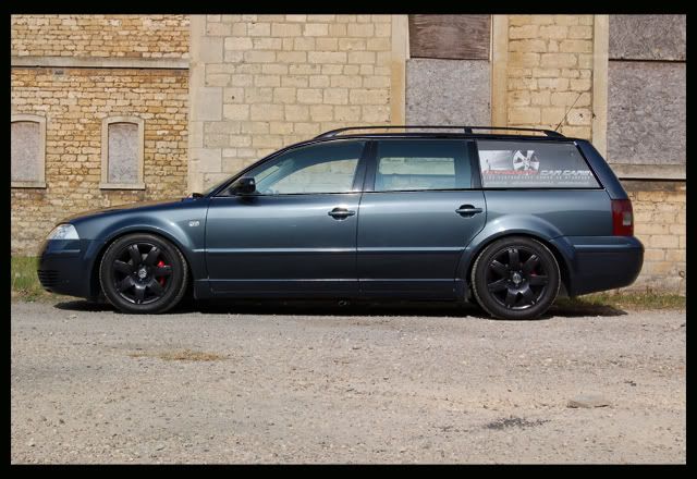

Next were the wheels. I couldnt find the wheels that really grabbed me, and everytime I did, someone had already done it! So for the time being, I painted my standard 16's Lambo Anthricite, which went with the whole stealth thing pretty well.
I also invested in a set of FK Highsports, and with a little help from a technician friend, got them fitted, and wound right down to the max. This was how it looked for a few months after that:
Unfortunately, I had to raise the car a couple of threads, as living in rural Lincolnshire, this ground clearence was almost undriveable:

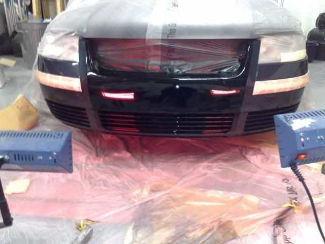

As soon as I got chance, the car was back off the road, and I decided to take the plunge, and completely smooth the bumpers, as I have not really seen it done much over here. It was a big gamble, as I didnt have any spare bumpers, but in the end just goit stuck in and went for it.

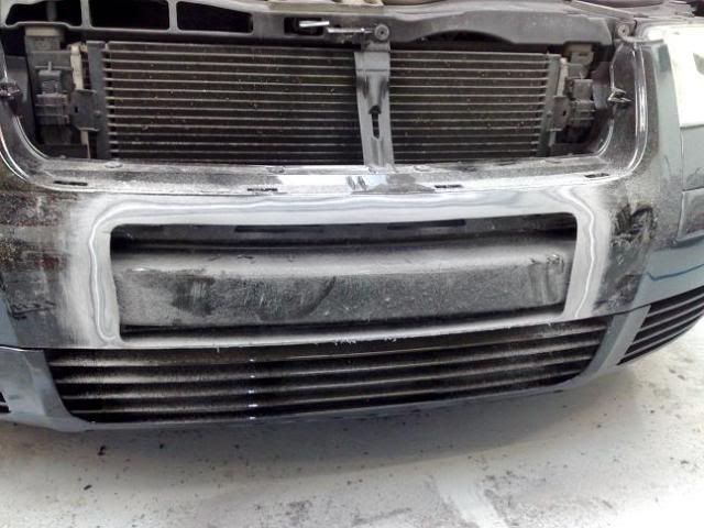

First I cut the re3cess out:
Trime the cutout and heated it to make it malable, before plastic welkding it back into the bumper:

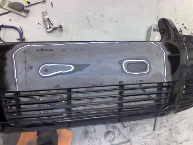

Filling was a complete ball ache, as recreating the shape isn't easy, but I got there in the end:
Primed:
Sprayed:

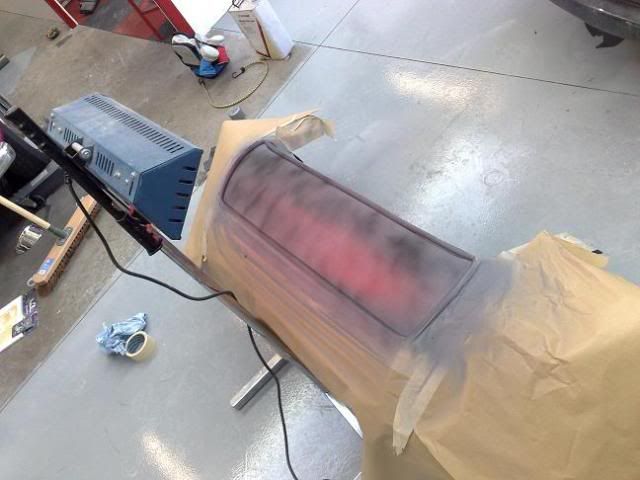

Back on the road again for a few weeks before I tackled the bump strips. These were a complete NIGHTMARE to get right, and althought a similar process was used, was alot harder to get right. The time taken for prep on the strips alone was touching around 40-50hrs id say, with alot of swearing, plastic welder bruns, and almost tears, lol!

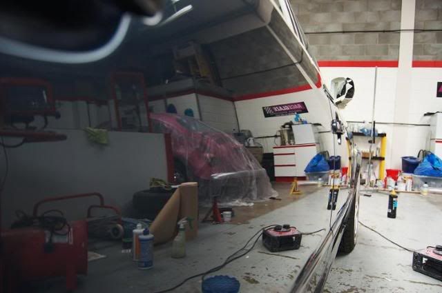

Finally, a mother of all details. I took 3 days off work, and spent around 30hours on the car, getting the paint as mint as possible.
Before:
After:

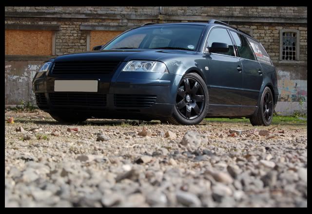

Finally, after 12months of mega hard work, 6 bumper resprays, two roof resprays, 3 bonnet resprays (Im a bit picky, lol), I finally rolled the car out and attended a show, where the car received a great response.
Im still not entirely 100% happy with the finish on the bumpers, as there a couple of small ripples I want to iron out, which will be sorted as soon as \i get another few days to spare. But for now, I am not going to miss another summer with it, and im just going to enjoy the car!!

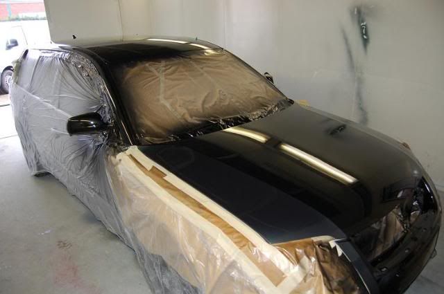

After knocking up a photoshop of the overall look, I began with the obvious, the bodywork, as being a paint sprayer it was the clear choice, lol!

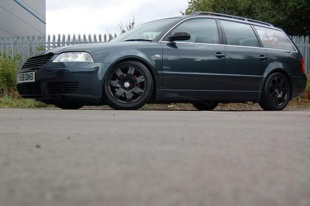

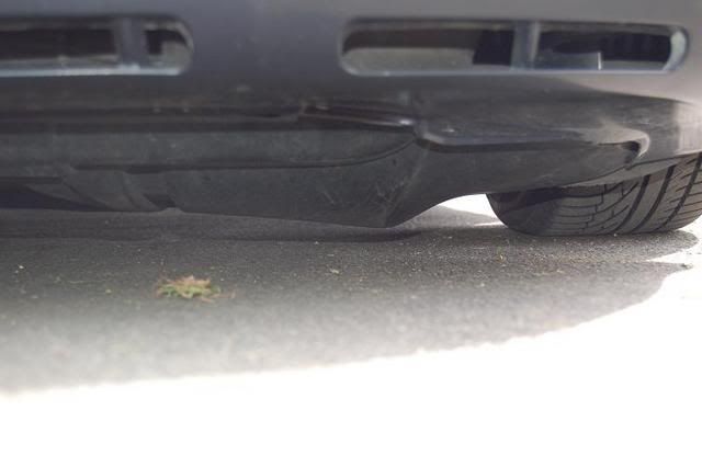

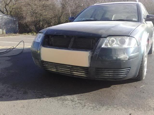

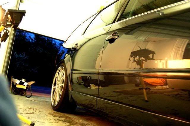

Before:
After:
