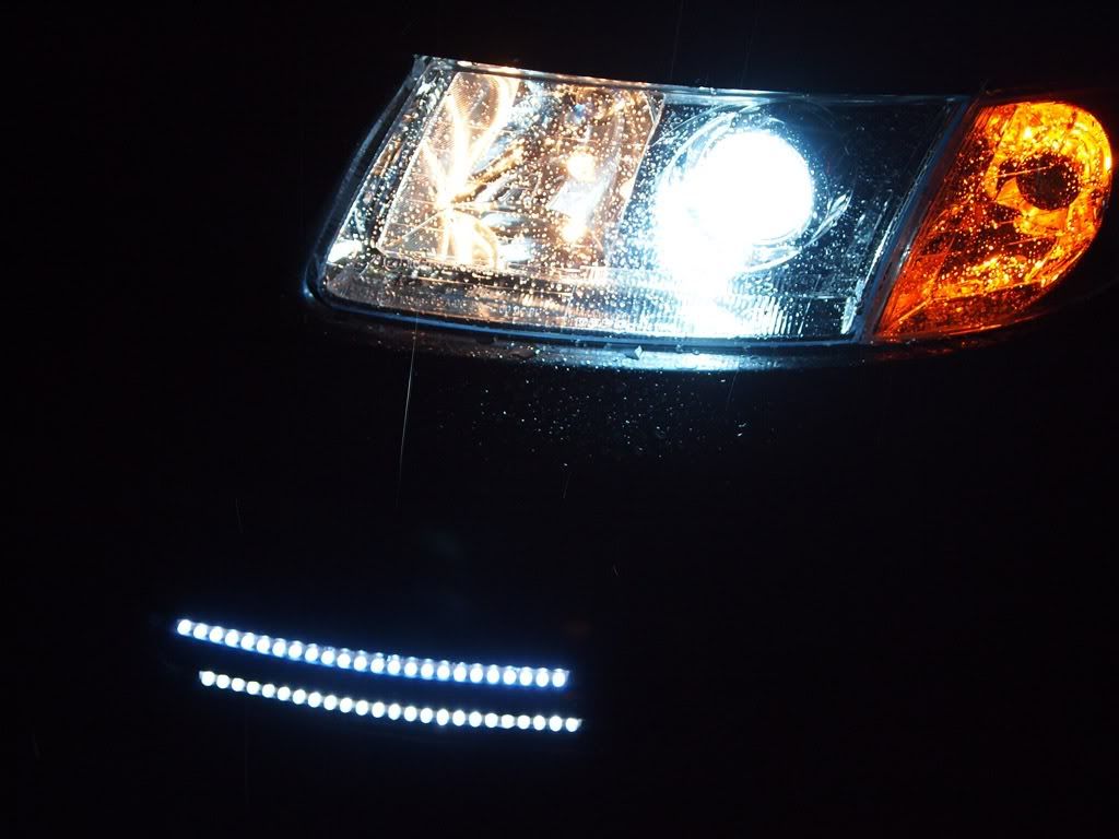

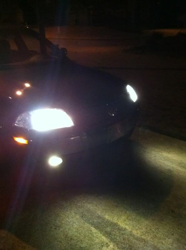

Hello guys a few weeks ago I replaced my city light bulbs with L.E.D.S I ordered online from autolumination which are the single LED CANBUS type. I would say there perfect as far as in intensity not to bright to my liking, see pics below. The lowbeams were done with the DDM Tunning 35w slim ballast 5000k HID kit. This new install is all supplied by the aftermarket euroswitch I installed not pulling any relays or throwing any codes.
HID LOWBEAMS WITH CITY LIGHTS
CITY LIGHTS ONLY

Remember as city lights they are not as bright as they look in my pics, this is a foward facing single L.E.D

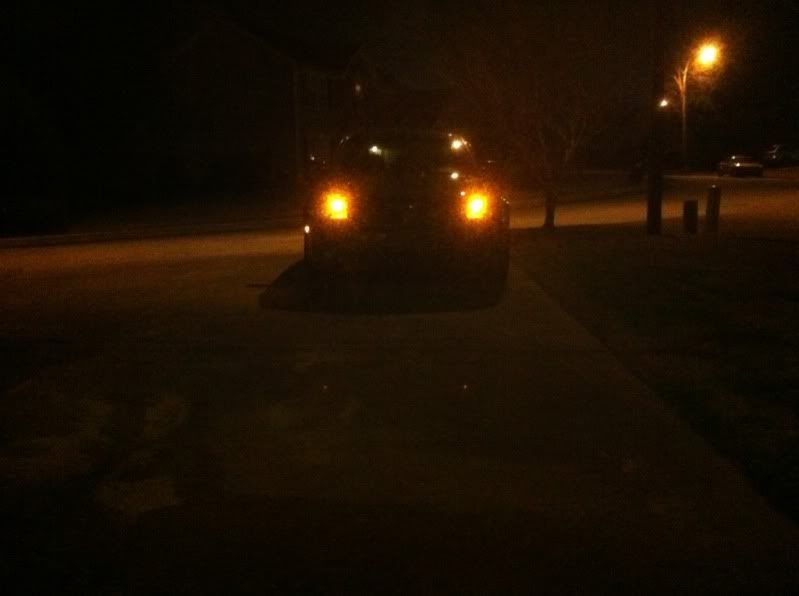

Just caution...they don't seem to "flood" the reflector with light, at least during the day. More like amber cyborg eyeballs. heh. My AZ didn't have anything but the amber and some weird rainbow ones that went blue, purple, red, yellow over and over again. Guess which ones I bought first by accident?
My iPhone camera really shows the light diffusing, but it really doesn't. It's 2 yellow pupils in the night. hahaha.
Not really noticeable with the XtraVisions and H3 fogs..

To see the uni-directional effect of the city lights, you really can't shoot them at night. Try shooting them in the shade during daylight or at dawn or dusk. They do appear as little white pupils.
Ziza LED City Lights only
Driver's side
Passenger's side
City Lights and 3000K HID fog projectors
LED license plate lights
And looking at these pics reminds me I have stealth bulbs for the corners I need to get in... :lightsaber:
