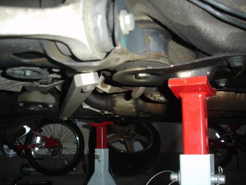

I am going to do a 4 corner brake job and bleed and clutch bleed. I have my car up on 4 jack stands positioned as indicated in the pictures. They all seem to be very securely seated. Is it safe for me to work under the car this way?
Front:
Rear:

Rears: Yes, I use that spot all the time.
Fronts: I wouldn't--that's just a thin metal plate and you risk sliding the subframe angles around. Go for the pinch welds or the flat spot on the floor pan specifically made for that (might be in the manual). Pinch welds are always the safe bet, but it's best to fashion some pads made of plywood to help even out the load. If not, the pinch welds will bend a bit before settling. This is normal, but not very pretty.
Just be sure to always give the car a nice hard shove from 4 different angles before getting under it. Also, place your jack and your removed wheels under the frame rails as a backup.
Then go with the horizontal section of floor pan inboard from the pinch weld. Make sure that you use plywood (etc) to create a flat surface, because I'd imagine the jack stand would cause a serious impression. That's what I used to do before I installed the TT jack pads--which are still my primary jack point, even though there is advice against it.

I've actually used these points, including the front points, a few times before, and I have never noticed any deformation at those points. I saw these points used in some old post here years ago, I don't remember where.I have TT jack pads which is where I lift with the jack.

The only problem I have with the front jack placement is that it is not a flat enough surface. It would be too easy to have the car slide while jacking the other side. I use the front part of the bracket where it attaches to the subframe bolt. I place the hook end right between the bolt and bracket.
I also use the inside of the pinch weld with the stand placed front to back.

Yes, I have definitely seen the sliding you describe. I keep a careful eye on the stands I have placed while jacking, and also jack incrementally, lifting a little at a time and then going back after all 4 are placed and then lifting again.

Yes, the same bracket but on the front section where the large bolt goes through it.
Most of the time I use the cup to jack the car up and place the stands on the inside of the frame rails. It just depends on how low the car it as the jack will not go under the cup on some of the lower cars.
I use the point that you are using to jack the car up, then put the jackstands sideways across the standard jacking points. My cheap jackstand has a little dip/slot in the middle to fit the welded seam. This seems to work very well.
One of points you have them are bad for the following reasons; The jack does not cup the spot up front so the jack top won't "squirt" out to the side. Very little movement would cause it to pop out and the car to fall. The passenger side doesn't look centered in the picture. The rears seem OK but I am not sure if those pivot or not.

the rears will not pivot. i often use that point for jacking, and the seam for the stands.
for the front, i have the same kind of jacks you do as well as the ones in the picture above.
the ones up above in the picture i agree are unsafe for that spot.

Thanks for the replies. I tried it the way PZ suggested, but with the shallow V shape of my stands, it looked like all the weight was pushing on one side of the hook, which to me didn't look like it directed the force directly downward under the stands. I just took extra care when lifting to make sure the stands were all at equal heights and that the parts on the stands were well centered. Then I backed it up with a jack on each side in front.
So I could put one of these V shaped stands under the flat part of the rail directly inside of the stock jack lift points?
