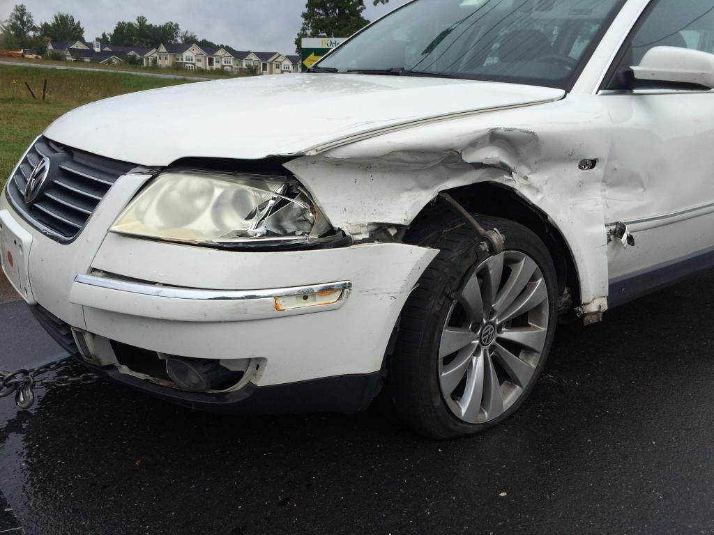

Hi all.
Today is a sad day for my 2002 GLX wagon. My wife got hit this morning. The wife is OK, but the car got hit pretty bad.
Is this fixable? I'm the original owner and would like to keep it.

Based on when my 2000 got whacked (not as hard) in the same place, you're probably looking at $3000+ - and that's without looking under the hood. They'll want to total it, but some clever picking at a junkyard would probably get you back on the road without too much trouble.
The only drawback with fixing it yourself and accepting the total is that you will now have a salvage title. IF you plan to keep the car until it dies, this may not be a problem.
I feel your pain... my wife had an 03 Passat wagon black, lowered, votex kit, hids, and she had an accident going about 30 mph. Insurance totaled it and I was besides myself. I did a buy back from the insurance co. and picked up a donor Passat for $300 locally. I have been swapping parts.. ie radiator, core supports, fans, fan clutch, pulleys, pretty much entire front end, minus the fenders and its almost 100% back to how it was before the accident. If your mechanically inclined, you can do the work yourself, if you have the time and the tools. Almost everything is bolted together with a 10mm bolt. Finding a donor will keep you cost to a minimum... like on craigslist. Best wishes!
Outside doesn't look that bad but I have a feeling strut tower may be bent and or doorjamb those are too bad places to have the structure bent, I would love to see picture of underneath the hood on that side (passenger side strut tower also because believe it or not that may be bent)and a picture into the wheel well(if fender was off even better) and possibly in the doorjamb I have done a lot of repairs like this and sometimes it's not worth trying to save it. I am not trying to talk you out of fixing it I hope it's not as bad as I think it may be. Also make sure the other doors even on the other side open and close properly and that the gaps are how they should be ,and the trunk opens and closes proper. believe it or not when a car gets hit like that it may have bent or tweaked the unibody . If you were planning on fixing it yourself you should also jack the car up and get underneath it and see how the front subframe is and where it bolts up to the unibody and look for anything else. These are other things to look for besides the obvious. I am assuming the engine and trans is okay! Good luck and I'm glad nobody got hurt!:wrench:
The thing to look at is the frame horn that the fender bolts to. If that is mangled it will be a little more complicated to repair unless you know someone who does collision repair. Other than that everything else can be replaced. Good luck, glad your wife is OK.
#11 ·
This looks 100% total loss (from the insurance's point of view) IMO. Since the upper control arm is now hanging on the outside, I would say damage to the strut tower and unibody is sure. To fix it, you need a body shop with frame equipment.

The car is at a local body shop that I've used before. He said my insurance co. will probably want to write me a check, but that I may have better luck going straight to the other driver's ins. co. since it seams pretty obvious that he is at fault. It was a 99 F150. Sad thing is he was able to drive away from the accident with only some slight bumper damage. All I see is the truck's bumper impression in the side of my car. The strut tower is what I'm concerned about. The control arm snapped off at one end and is now sticking out. That can't be good.
The other thing that's not sitting well with me is that the passenger side air bag was activated, but the driver's side did not. Has anyone ever had or heard of faulty air bags?

It's a 12-yr-old station wagon. Unless it has practically no miles, it's guaranteed to be totaled. As you and several others noticed, one of your UCA's is now facing the wrong way. An impact enough to do that probably borked your steering rack, frame, strut tower, axle, and who knows what else. You popped an airbag, the unibody got creased at the doorframe, there's a whole pile of trim that needs swapping, you get the idea...

Whether or not you keep the car will depend on how hard the F150 hit you and the subsequent damage to the left shock tower. If there's shock tower damage, to the point that the front end can't be aligned properly, I'd advise selling it; otherwise, have it repaired and keep the difference as a large down payment on your next car.
If the airbag has been deployed, that wraps it up.

OP, the way each manufacturer decides to deploy airbags is a very complicated scheme and algorithm, based on a lot of factors and inputs from various sensors. If the airbag light was not ON on the car prior to the accident and the driver's side airbag still didn't deploy, I would say all was functional and correct, but the decision was to not deploy it...
The fact that the other vehicle had minimal damage is just a psychological factor (is my car weaker than his?), he hit you with a very strong area (corner) into a very damageable area in your car. FYI, later cars are very damaged (damageable I should say) in accidents (I am talking serious accidents, not yours) with design features like "crumpling areas" to minimize occupants injuries. Initially the cars were all solid as a rock, but tests proved that was a wrong approach.

Yep; unless you are seriously injured by a part of the car the airbag is supposed to protect you from, the airbag is working as designed. The airbag exists to keep you from getting killed or sustaining serious injury. If the accident is such that you aren't in danger of serious injury, the airbag itself is more dangerous than the accident.
If the passenger seat was empty, I don't think the B5.5 has sensors to detect that there's nobody in it, therefore it cannot distinguish between an empty seat and one with an unbuckled passenger. (The system is more likely to deploy if it thinks it needs to protect against an unbelted passenger, which makes sense.)

Yeah. I go back and forth on whether to fix or total. I guess once I get the adjuster's report I'll have more to go on.

Also went to pick up some things from my car today. The driver's door is pushed back a bit, but it closes with a slight over hang. Peeked at the engine compartment quickly, and it didn't seem to be too bad. The fluid containers were shifted over though.
What to do?
