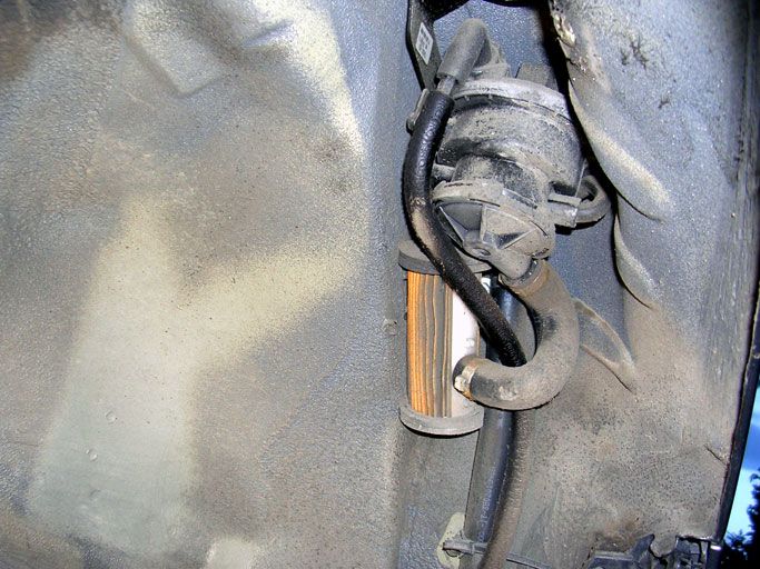

Today I checked my rear sunroof drain hoses, so I had to remove the wheel well inner liners to access the discharge ports/nipples.

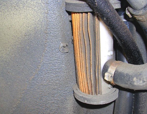

In any case, it was a first time for me to encounter this... thing and its grimy filter.

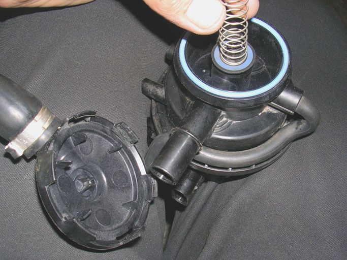

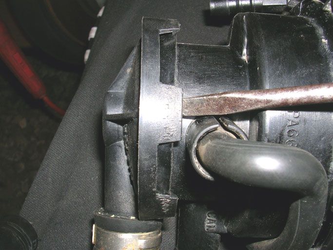

Being so filthy, I removed the whole thing to clean it. Disconnected the power connector, unattached it from the bracket, disconnected hoses, removed the filter, and opened the pump's top, since I was able to do it easily.
I don't think I've seen a spring popping out, but then I noticed it on the floor. There's a little bluish valve under the top that popped when I blew through one of the openings, but I'm not sure if the spring popped out with the valve, or it did when I first opened the top cover.
If anyone ever opened one of these things, would you be kind to share if the spring goes on top or under the little valve? I assumed that it goes between the valve and the top cover, but after reassembly I blew through the same opening connected with the valve and the air goes in freely - it seems that the spring does not do much.
I would appreciate very much any insight. Also - could the filter be washed/cleaned and reused? The little bugger costs a whopping...$ 45 :rolleyes:. That's just insane...

Not an expert on the LDP, but I'm pretty good with filters. Assuming the element isn't some kind of paper that will turn to mush, you can restore a little flow by "washing" it, but not much. On a typical filter element, the real action is down in the pores of the filter, and you can't get much out of there. Surface crud is just what builds up after the pores are clogged. This is a pretty non-mission-critical part, so I'd likely just brush/blow it off rather than spend $45 for a new one.
thanks much, gents. I appreciate the help.
I was actually thinking to gently wash the filter with some Dawn and then let it dry thoroughly for the rest of the week, but I'll try air-blowing it.
When I cleaned mine a while back I just blew on it with a vacuum. Mine was about as dirty as in your pics. I wouldn't try washing it.

Based on the video course's illustration, the spring is on top of the valve so I'm ok.
I'll watch though the course again to better understand the fresh air intake/vacuum cycles that close/open that little valve. It sounds like by "default" the spring doesn't push too hard on the valve since it needs to be open to let in fresh air from the filter. When the vacuum cycle kicks in, then it closes and the spring provides more of an aid in closing it, rather than be the main closing factor. Actually the coils are pretty loose, doesn't seem to carry too much tension.
