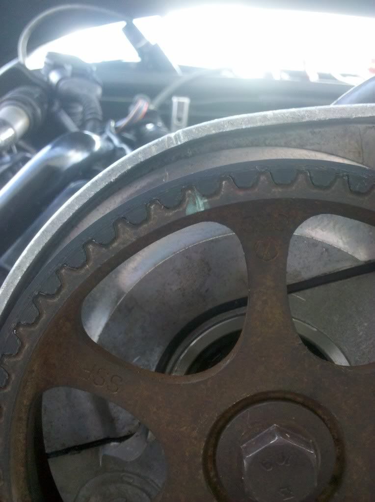

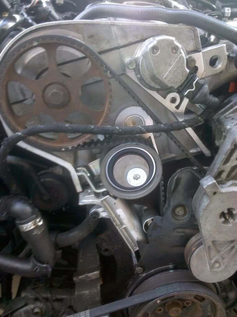

Im not with the car right now, but I can get some pictures posted this afternoon some time. The cylinder head I put on is absolutely brand new not rebuilt, or remanufactured. It came with new cams, and everything except chain, and tensioner. knowing this do I still need to do a compression check?

I will do a compression check in the next couple hours, as well as get pictures on here. When I do a compression check, what sort of indication will alarm me that the intake cam is off a tooth.
The cam journals did not seem to be in bad shape, but I will get a picture of them so you can judge.

Just noticed your crank pulley is holding by only 2 bolts. are other 2 holes accessible for bolts? As far as marks they look too good. Mine is half a tooth off.

135 is way low for a 'new' head gasket and head. But if it's a solid 135 across the board... Did you check the timing marks BEFORE you took your engine apart? I did the head gasket on my old '87 Golf in my backyard years back, and when it went together I double-checked the install. The timing marks were WAAAYYY off, but the timing was correct. Had I lined up just the marks, it probably wouldn't have ran...
#28 · (Edited)
I have taken off the valve cover so many times and adjusted one tooth either way probably eight times. All the keyways line up at TDC. I don't see how it can be the timing. Through our trial and errors we would have had it close enough in time to at least start poorly. It is not starting at all. Everytime we made adjustments we craked it over by hand as well to be sure and not bend the valves.
