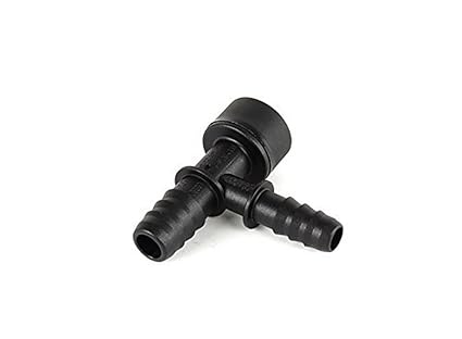

Which bleeder valve did you get? 6A is not the correct bleeder valve for a 2002 AWM. You need #6, which is 035 103 245 A . You may also need a suction jet pump (058133753B), it clogs easily.
Your breather system should look like this instead of the 2003+ image above.
Also, I would go ahead and remove the intake manifold, It's not hard at all. Makes everything so much easier.

Woodward is correct. I didn't have the early AWM/AUG breather pic to attach. Even if you got a 6A by mistake, you can always just put a vacuum cap on the side port of it.
You don't really need #10 hose up to the intake manifold if it's not torn or abraded. The SJP is a good idea if you've never replaced it. Just waiting for mine to split or clog @172k

That's the right one.
The one in the above diagrams (for the late AWM's) looks like this:
Here is a better diagram. It says AUG, but it's the same as the early AWM's
