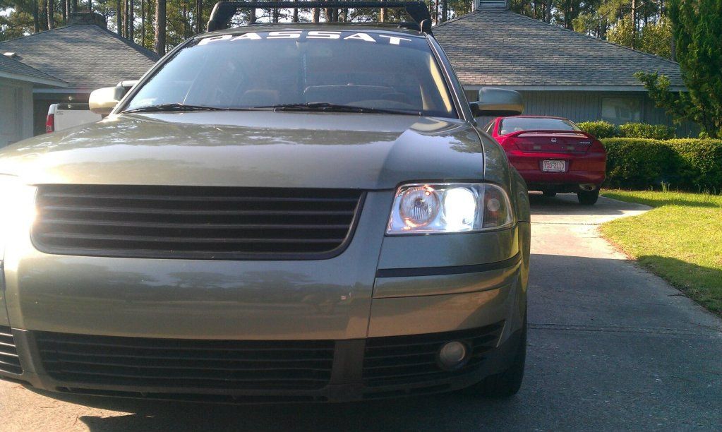

Note the color contrast of the 4300K with the incandescent city light before I swapped it out for a bright white Ziza LED.

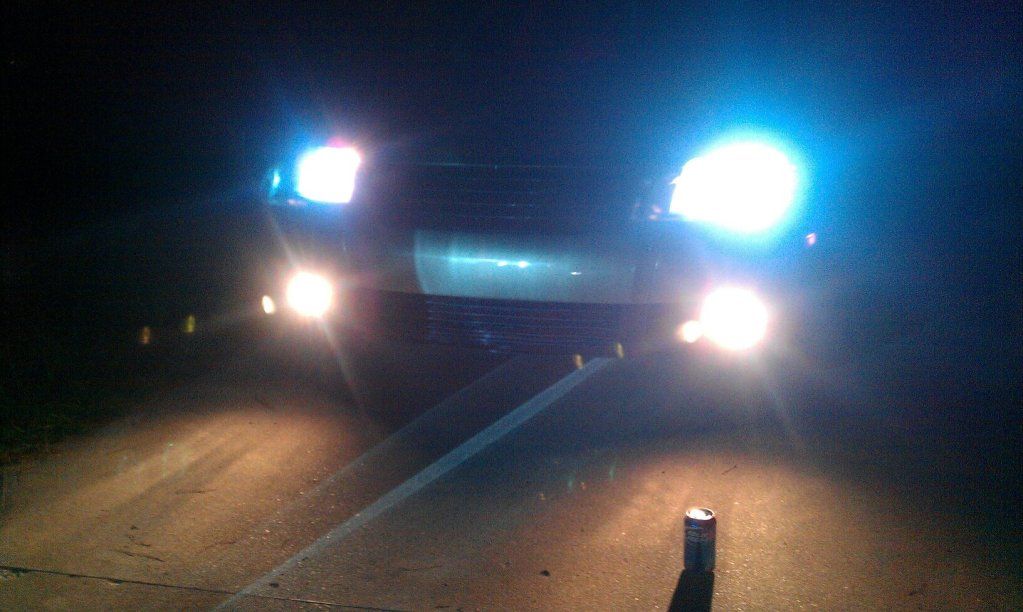

In this photo, the 4300K low beam projectors are off and the bright white Ziza LED city lights are illuminated with the 3000K fog light projectors.
