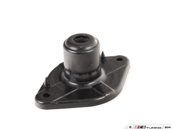

I agree on this one. Look in the rear spring lower area for a possible broken piece of the spring. Just happened to me 👍. Good luck
I replaced the spring on the driver's side rear and this noise is on the passenger rear side. It did pass inspection, but perhaps they missed that spring? They did miss the front driver's spring as that was the first spring I replaced... I'll check - and get the new rear shock mounts
These are actually the ones that fit the 4-Mo:
