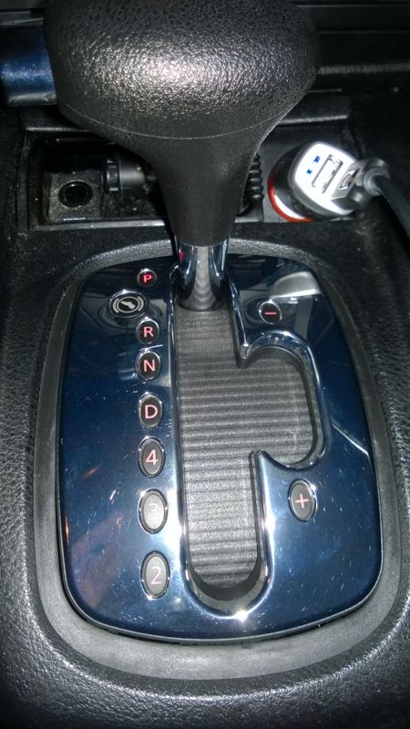

So, one thing that I just didn't like was 'forward: up; rearward: down' on a Tiptronic. It's just backwards.
So, this happened yesterday......
Ok so how did you manage this to is there a write up somewhere as , I bugs me and I've only had the car 2wks !
Sorry, I didn't do photos as I went.
But, here's what I posted at the Vortex:
Wiring is easy: just swap pins 4 & 5 at the selector plate.
Swapping the + and -:
Remove selector plate, unclip circuit board from it. Gently work the number plate off of the cover (might need to warm it up a little to soften the tape. Mine, well, the tape was *just* holding it, barely.)
Cut out the + and - with a Dremel. A little epoxy to hold the number plate to the cover (and, clamp it in place while it cures!), and a little more epoxy to glue the + and - down. Edges only here: don't want to cover the exposed backside of the characters that you moved, lest the light not shine thru them anymore.
Total time: about 90 minutes. Best spread out with an overnight in between glue work and reassembly, so that the epoxy can fully cure.

(note that photos 2 and 3 are incorrect. The shifter MUST be in D3 (or lower) to take the console out. Also, the ashtray will stay with the console (if it isn't already broken, of course. )
