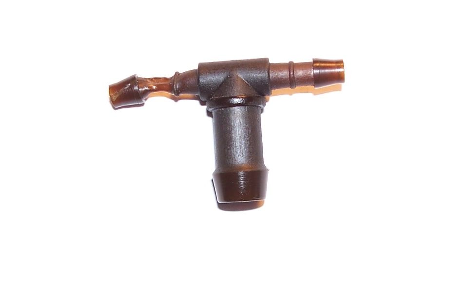

This is how the T appears if care is not used when removing the tubing
The T is VW part number 078129737A
The hose is 7mm ID by 2.5mm wall and requires 50mm (2 inches) of VW PN 443121107A Vacuum hose, but it is sold in 5M lengths.
