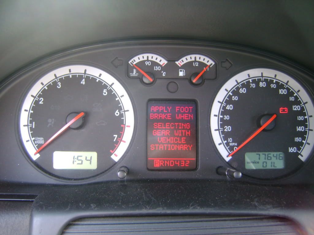

Extremely Early B5 & 1998 Featured
Bango KeyFob
Green Backlite Dash Lighting (Early )
White Cluster Needles
B4 Passat Single Din Radio (Early ) No K-Line Wired
Belly Pan Had Foam Attached To It (Early ? )
Two Peice Engine Cover
Smaller Sized Front Rotors
Two Rear Headrest, Middle Lap Seat Belt
Amber Corner & Side Fender Lights
No Low WasherFulid Or Worn Brake Pad Idoit Light (Early )
Early CCM Were Not Able To Accept Re-Codeing
Unique Side Mirror Switch
Rear Defroster Was Not On A Timer (Early)
Stubby Passenger Mirror
Thats My FIS Cluster Picture :)
I had to use someones picture that most likely would not delete it; lucky sob I can't wait to get a Full FIS and finally see my Navi. displayed along with the lamp failure indicator :whistle: and all the other goodies.
