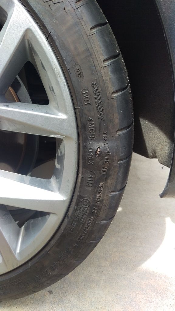

I should start by saying, the shop is replacing the tire free of charge to me, so I'm not mad. They're making it right, I'm just wondering how it happened.
I found a small bolt in my tire this morning.Took it to shop #1, they looked it over and said they could patch it but were busy so I went to shop #2. I left it with them, and when I came to pick it up, I found a sidewall bubble with a gash in the rubber. I talked to the manager and he agreed to replace it. He didn't really explain how it could've happened but I'm curious how. Is there something about the machines they use that can cause this, and is it due to having low profile tires, which I hear are harder to mount?

Maybe the tech set something on the tire and left it there as the mounting machine was turning the wheel and it jammed at the arm and cut through the rubber.

Normally, I'd look at that and call it an Impact Break. Possibility that when mounting it, they used the bar sliding around the bead to get the tire on the wheel. If they hooked it under the bead/sidewall way too hard, they tore the liner from the inside, the air migrated between the layers just as if it had impacted a pothole from the outside and caused the bubble to get big enough to tear the outer sidewall. If that was the case, if the tech went another 5-10 psi higher with the pressure to seat the beads, he would have blown the tire right in his face. By the way, that tire is 2 years old lol.

Right, I would've chalked it up to a pothole if it hadn't been there when I pulled in and if the rubber hasn't been sliced.

Something definitely poked that tire. You can plainly see deformity right on the word 'TREADWEAR'. My guess is they caught the inside of the tire with the tire mounting machine.

Ouch, that bar will be marking up the edge on that alloy rim unless there is something soft where it touches the turning wheel.
If the tech is doing it right that bar moves with the wheel so damage isn't an issue. I've used a similar system to mount tires on my OE Mazda 18x8 and Enkei RPF-1 17x8 wheels for my race car.
Of course, it's very easy to do it wrong.
I see what your saying, it will rotate away from the vertical bead breaker.
