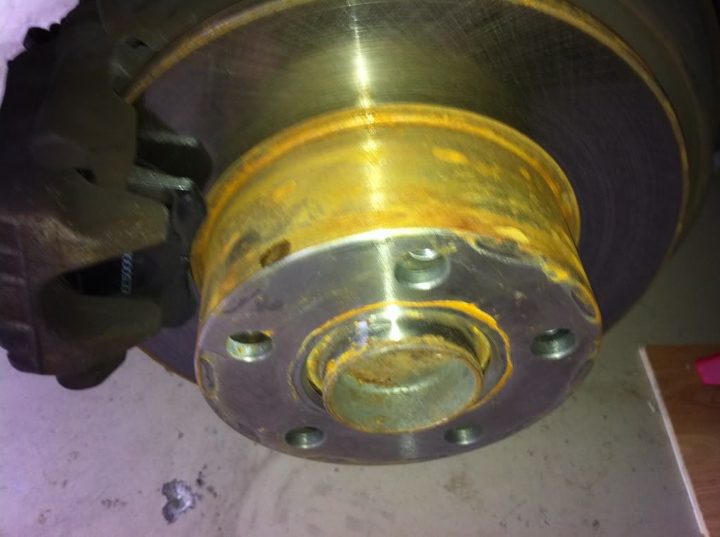

yes, if you mean the rust on the top hat.
it's amazing that you still have some of the original crosshatching finish on the rotor face, as well.

Discussion Starter · #4 ·
Just for info, below us my front rotor. It's the original one, I bought the car in 2001 Dec, I am at 125600 miles currently. I still have the original brake pads on the front.

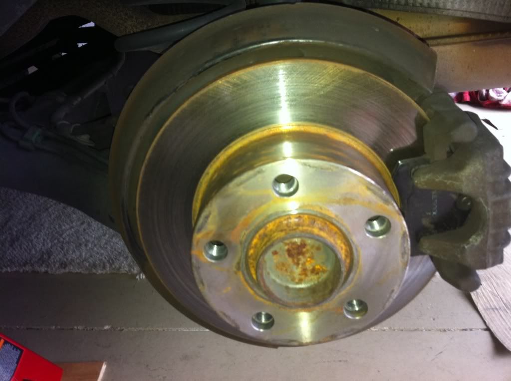

Below is the pic of the old and new rear rotor that I bought it 5 months ago.
The old rotor was the original one on the car.
