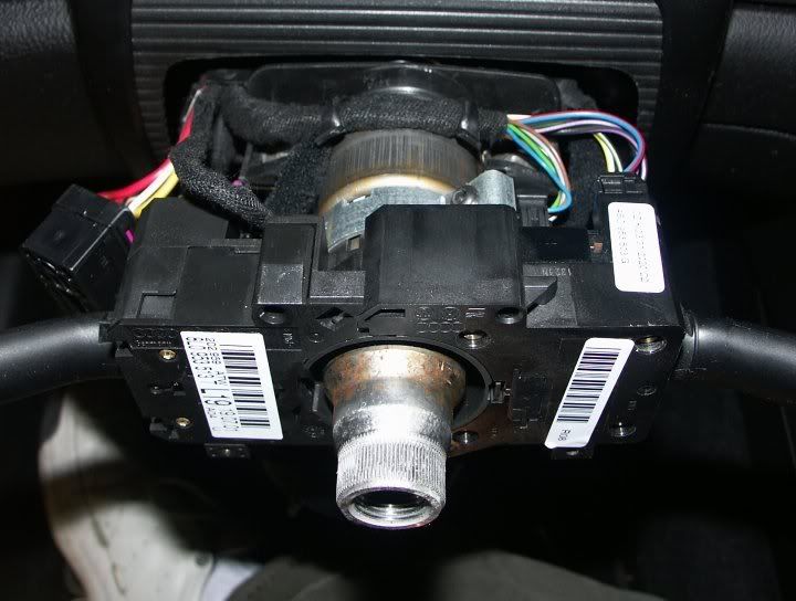

So I've removed the airbag, the steering wheel, and I'm now a bit stuck. Sharky mentioned that the stalks are assembled like a puzzle and removing them can be a bit tricky, he wasn't kidding. I don't want to break anything trying too many methods so I thought someone could give me some direction.
The reason for all of this is to remedy my turn stalk that keeps ticking even after it's in the off position. I have replaced the emergency flasher relay already and that is not the culprit. My attempt is to remove the turn signal stalk, clean it, and then reinstall it. If that doesn't cure it I'll have to go back in to replace it, but that's another chapter I hope not to write about.
Here are some shots of where I'm at.
Above Angle
Front Angle
Below Angle
Right side (Key) Angle
And in case someone might know for sure, the below is a picture of what I thought could be the problem. It's an electrical strip (for lack of the technical term for it), that looks to be black coated everywhere else but on the bottom exposed section. Not sure if that would cause any issue like what's happening but it does seem that the coating has worn off here and it does connect to the turn signal stalk. Would this be anything that would cause an issue like this? Or would this type of wire strip be for something like the Cruise Control?

According to Bentley you're just about there. Just loosen the bolt on the clamp behind the switches and it should slide right off. See the picture below. They also have a caution about the spiral spring remaining on the steering column switch. Ensure the spring is not turned from central position. Just quoting the manual, I haven't actually done this before.
Duh! Ok, I feel stupid. Yeah, that did the trick. Thanks for the help. I know have a fully functioning turn signal stalk again. :thumbup:

Glad it's fixed. I assume you cleaned the contacts on the switch, and that the harness-thingie was not an issue?
be careful when you remove the electrical connection, especially the small inboard ones.
I'm going to tackle this job myself eventually -- I have the same nastiness on the flexible plastic wires on the bottom of my turn signal switch, and I'm hoping against hope that it's the reason my cruise control doesn't work. Good to see someone else managed to do this without catching a faceful of airbag.
Yeah, I'm assuming that it's part of the Cruise Control. Everythings working fine, though I haven't tried the CC yet. Let's hope that I don't set it at 65mph and find the B5 speeding up to 90mph on it's own. :nervous:
Not sure which electrical connections you're referring to. Regardless, I was very careful with everything I touched.
I was talking about the two closest to the column, there small and the on is hard to see how its held on, at least I thought so.
