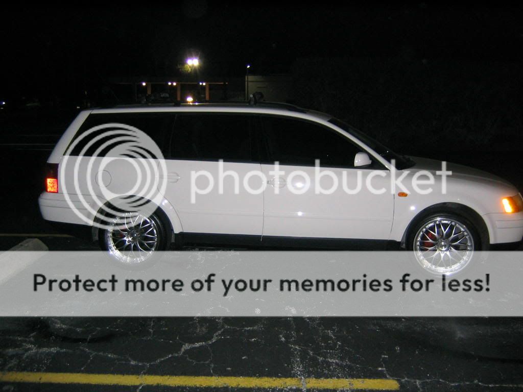

1,600 Posts
HungLo said:
On my last car, I had 17's on.. I didn't really mind the wheel gap, because my car still drove really nicely... If I go 18's, how bad does the gap look? Or how high-jacking am I going to be?
Probably something like Surfwagon's car:
/karl
