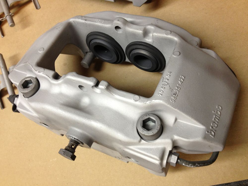

They're here! I picked these up from Godspeed last month. They are incredibly clean and, actually, nearly ready for refinishing. Little or no further prep work required. However to powder coat them, they will have to be disassembled completely, so I will have to blow the pistons out, strip the seals and screw fittings, etc. But all the parts are in very good/excellent shape, and it looks for now that I will not have to spend any monies on Porsche rebuild kits. :wrench:
So here they are in their "before" shots:
I know I have argued in other threads that solid surface vented rotors are better, but these are screaming, no howling at me for slotted and drilled 312mm vented discs. And probably EBC Red Stuff pads.
Or perhaps I will stay with PBR Deluxe Ceramics and get the calipers finished in Guards Red powder coat after all... ;)

Am I to assume the series of numbers on the calipers represents:
986 designates the vehicle model number
351 designates front calipers (352 designates rear)
421 designates left side (422 designate right)
shown as 986.351.421
Are the Boxster (986) and 911 (996) calipers interchangeable?
