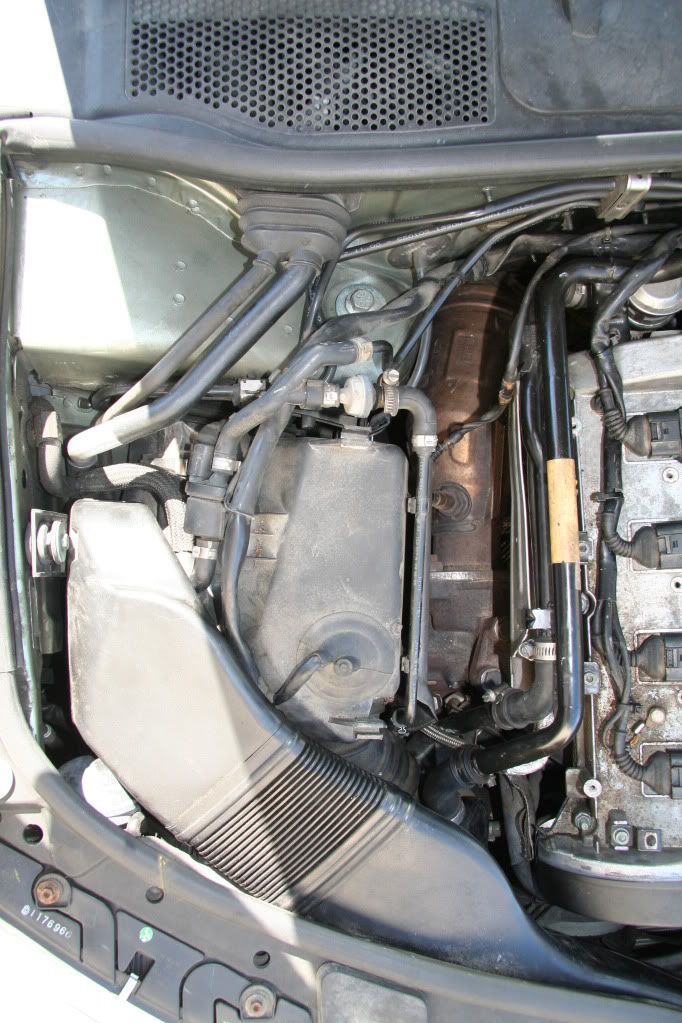

I see that Steve is quicker than me:hatoff:, but here's another picture...
You can see the catalytic converter in this picture of my 2001.5 AWM, taken standing in front of the right (US passenger) headlight:
The rusty colored objects, beginning at the front, are:
  • the turbo
  • the pre-cat oxygen (O2) sensor
  • the catalytic converter itself
The post-cat oxygen sensor is further toward the rear of the car and below, out of view. The pre-cat O2 sensor is actually screwed in to the cat housing--the flange that bolts the cat to the turbo is in front of it.
