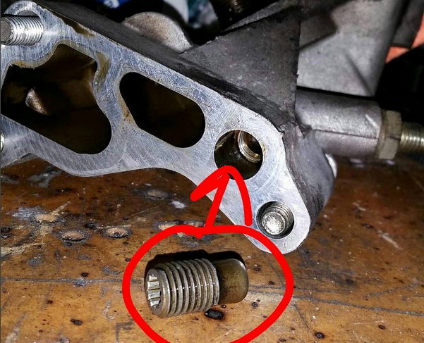

The problem with that is that I haven't changed anything with the setup or oil sender.... EXCEPT when I removed the oil sender from the block originally, I found a check valve of some sort that was completely backed out ( SEE PICTURE )
I'm under the impression that this is a "Oil Retention Valve" which is supposed to keep the oil in the galleys in order to keep the bearings lubricated. Could this in anyway effect my oil pressure to the turbo?
