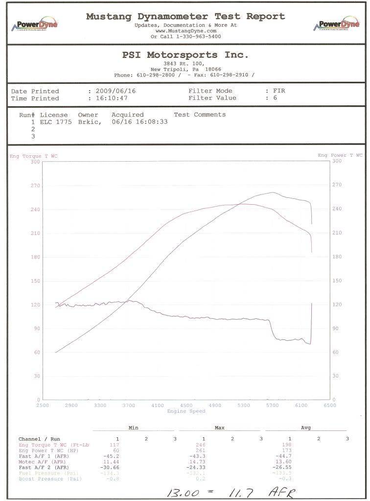

GT2871 Elim.,630cc injectors,3" test pipe FMIC
BT unitronic software 3"vr6 MAF
Full 2.5" TT exhaust with down pipe and borla mufflers
Spec stage 2+ clutch with stock flywheel
Stock fuel pump and exhaust manifold
Nothing that you guys didn't see before.
Running 18psi 261 whp and 247 wtq
154 Posts
those numbers seem a little low...
I got 242whp and 252 tq at 17 psi with stock intercooler, exhaust and clutch. The rest is the same setup but I'm running the Eurodyne software.
