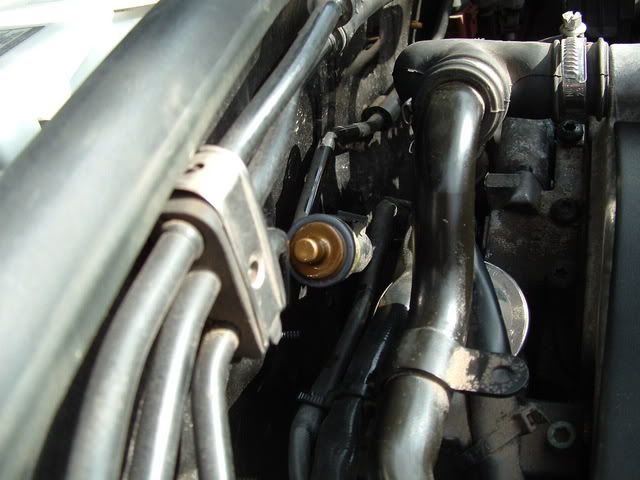

OK, got the darn thing installed.
Took me about 2 hours (including an oil change). This is definitely not a job for anybody with big hands. Here is a pic of the sensor after I got it released and pulled it up to withing view. Notice all the hoses and such around it and try to imagine having to find the sensor under all this crap.

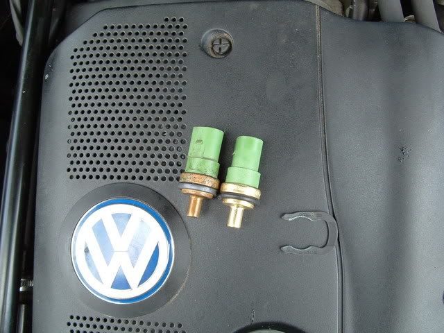

Here is a pic of the offending sensor next to the new one.
Sure you can tell which is which.
Oh yeah, and see that little POS black clip next to them? That is what holds the sensor in. I must have dropped that thing at least 4 times. Twice it fell all the way through to the ground, twice I had to reach up in and feel around on the cross members and such to locate it. This is the part that took me so long. Trying to squeeze one hand between the firewall and push the sensor down, while squeezing another hand back there trying to get this clip back on.
I think if I had to do it again, it would take no more than 20 minutes. Hopefully, I won't have to do it again.
I would like to thank everyone for the help that was given in this post, and if anyone needs help changing this sensor on an AUG engine, just give me a holler.
