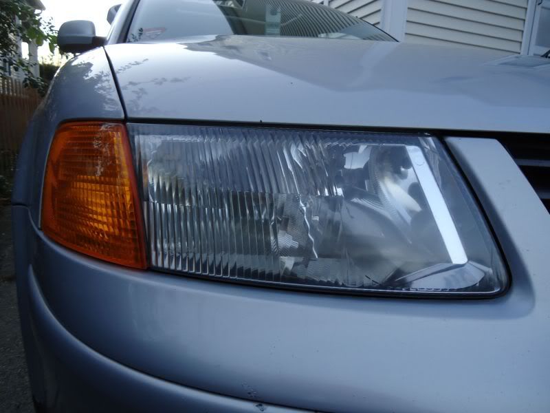

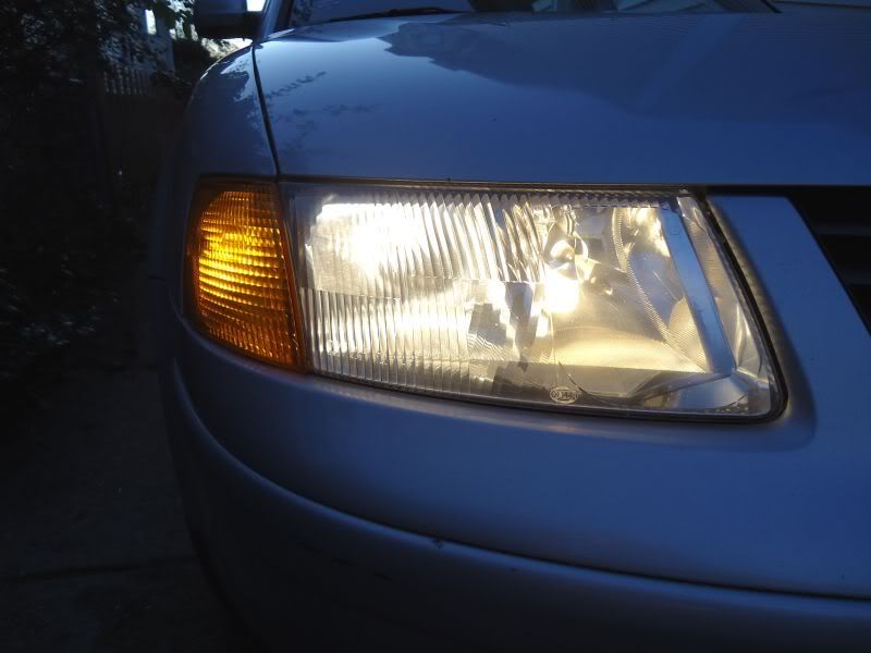

2 days ago I refinished the headlights on my 98 passat with 213K miles, and have the result listed below
I went with sanding off the old finish, buffing it out a bit, and putting on a new clear protective finish
I can share the tactics and what I used if there is any interest :wrench:
They came out great and look new, car looks much better now with them refinished

Its called crystal view, its a kit sold on and off locally here at walmart and advance auto.
it only re appeared here after several months, not sure why.
what the kit contains is 1000 and 2500 grit sandpapers, some small cloths, a buffing compound, and a clear finish glaze.
all these things can be had on their own, I just wonder what is in the clear finish that comes with it
ive done a few cars with this kit, and have always gotten good results. the key with refinishing (whether its a headlight or a painted surface on your car) is it must be ready for the new surface/paint.
the headlight will only look good if ALL the old finish is sanded off and removed, often times it takes a good deal of sanding depending on what was originally used to coat the headlights

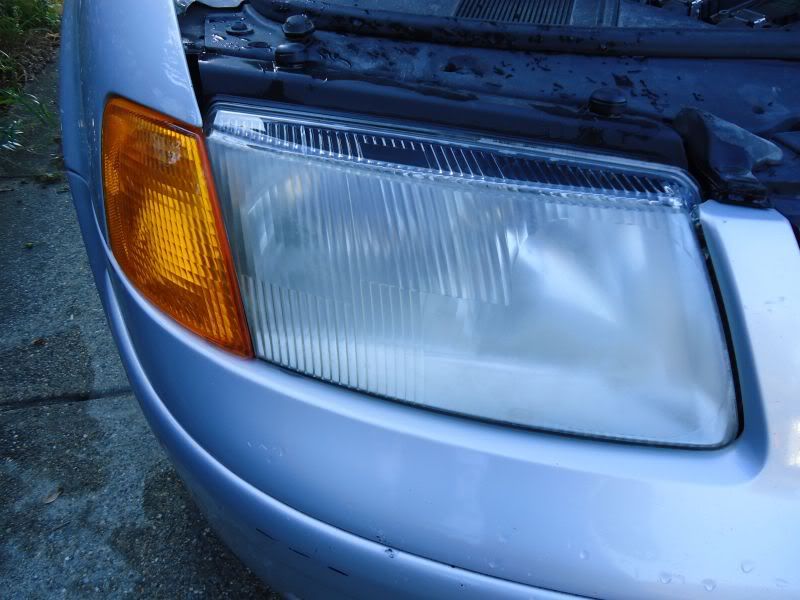

Thanks for the tip. I'll have to try this as my headlights look horrible. I have tried the Meguiars or Mothers and it was okay... but they got just as bad again. Was thinking about replacing them, but sinking large amounts of money into them isn't an ideal solution for me. Maybe this will save me, from your results it looks like it is at least worth a try.
55 Posts
I have the Turtle wax one as it was on sale at the Local Autozone, I'll be doing this probably tomorrow. I'll snap some pics during it.
Make sure to get some masking tape and mask off EVERYTHING around the lights if you get that on your paint it will destroy it.

I did the Crystal View restoration yesterday. Worked great. I'll probably create a DIY thread sometime since I took plenty of pictures during the process. ~$20 from my Walmart hard to beat that since it actually works. It will be interesting to see how they look in a year.
side note: My Walmart didn't have it near any of the other headlight restoration kits.... the CV was hanging over by itself next to the fuses....
