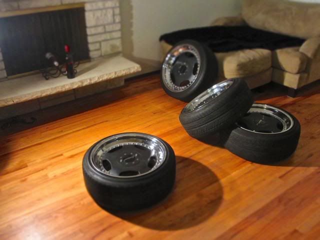

So I pulled off the wheels for winter, as I replaced them with GTI Classix on Blizzaks for dirt cheap, and we started with this mess..

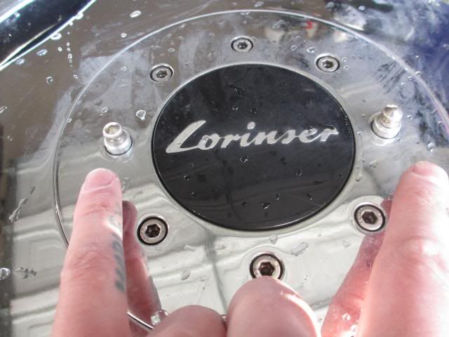

Previous owner failed to provide me wither center cap removal tool so I have improvised with these two protruding bolts per wheel

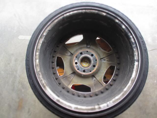

Now onto the bad stuff…the back sides of these wheels were pretty battered to start with. Lots of axle grease…yum!!
And lots of hardened grime…on each bolt.

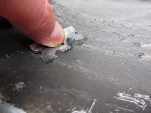

So on to the first step..scraping off all caked grease. Believe me it was thick.
Once I got off as much as I could it was time to scrub down with scotch brite pad and degreaser.
Which got it to look like this. But we still have a lot of wheel weight residue left on there

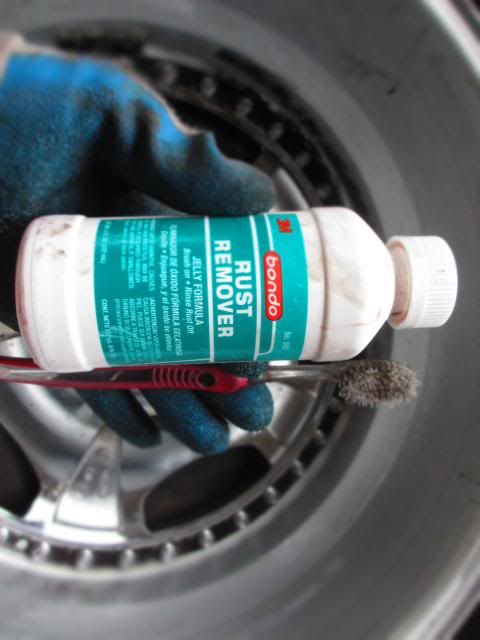

So then they all got scrubbed with Bondo brand rust remover.

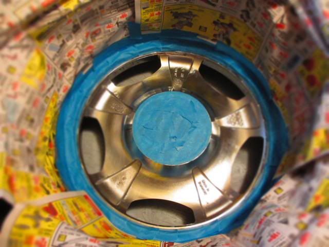

Masking off.

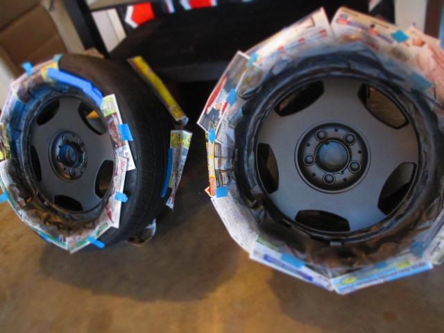

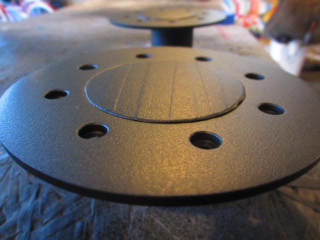

Plasti dipping wheels.
Dipping center caps.
Letting them dry after plenty of coats.

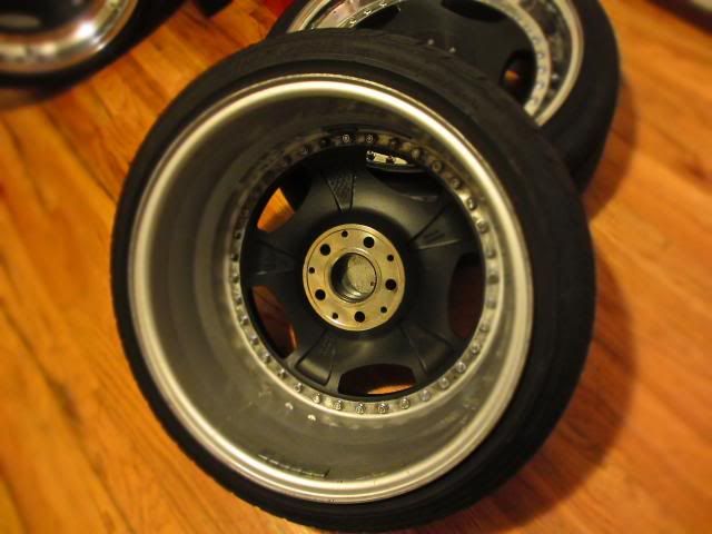

And the final product all together.
Back sides are looking way better..i swear i heard this wheel whisper "thank you"
Chrome is looking so much better
Happy with the outcome.

Masking off.
