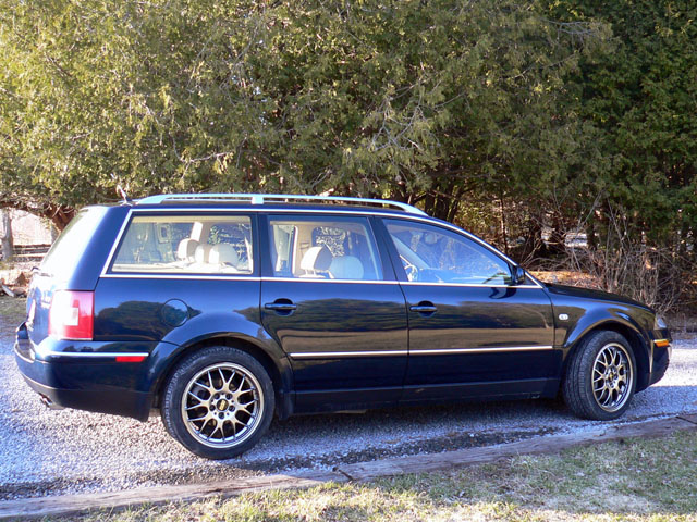

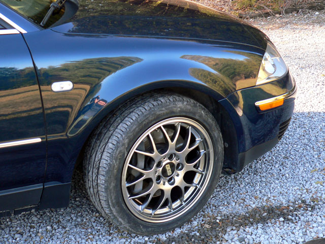

I think I might need spacers for that setup to work... but how much? The stock "sport pkg" BBS Madras rims (17x7.5) are 45mm offset - does that mean I need a 10mm spacer?
Anybody done it? I'd love to see pics on a B5/B5.5... on a Pacific Blue Variant might be much to ask, but that'd be cool...!

For my own edumacation... a spacer wouldn't necessarily help anything as far as clearing the calipers is concerned, just prevent rubbing on the fender wells and such in the twisties?
I saw Blownaway's threads, and I think it ended up that he kept a set of the RGRs, with spacers, but... I'm not sure. It wasn't clear. He was also running a Stoptech BBK, IIRC...
Ah well - I'm having second thoughts anyway... Not sure if the black finish would look too hawt on a Pacific Blue W8 Variant, with the chrome accents (rub strips, roof rails, etc.). On a black car... sexxxy
