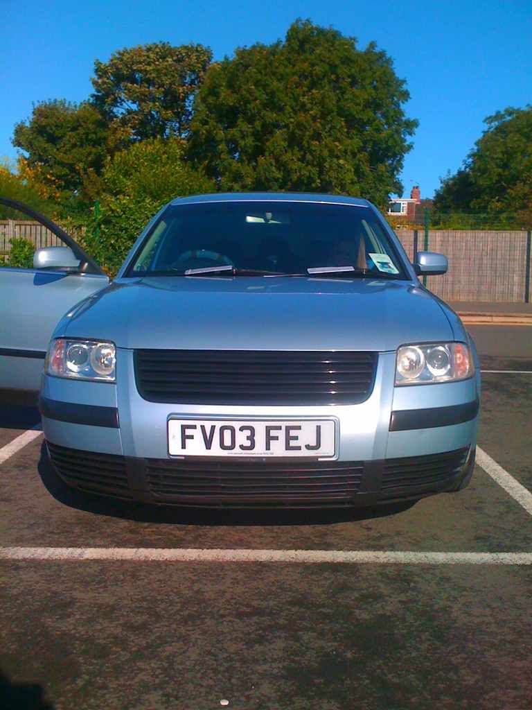

well it started in 2009 when we decided to look for a 2nd car , after wanting something different from our usual vauxhalls & fords we decided to look at vw , 1st we were looking at a bora tdi when we were offered from a family member the chance to view there vw passat tdi , on 1st viewing i have to admit i was not attracted to the colour or the fact it was dirty with missing wheel trims =;
after a few nights contemplating i took it for a test drive .... i was instantly impressed with the feel & sturdiness of the drive it handled well & seemed to have a very responsive accelerator :D
i was told to keep it for a week while i decide but truth be told my mind was already made up ,

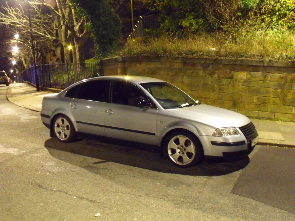

so here how she looked ....
i have always liked my cars to look slightly modified nothing other the top ...... eg; alloys , tints , exhaust trim , leather interior , & keep them clean / tidy ( which is hard with 2 kids & the mrs ) haha
i said this time i was not going to do any changes & just enjoy free motoring , which didnt last long , so while on ebay i started looking for some alloys to get rid of the steelies , after searching for some thing local i found some audi a4's , over all in fair condition so i sent the ebay message do you have a buy now price in mind? the gentlemen replied £40 so i said im on my way haha,
when i got there he said one tyre will need replacing so you can have them for £30 i shook is hand & said thank you as i was loading them in the boot he returned with a bag of wheel bolts plus 2 sets of locking nuts , obviously i was over the moon 5 alloys wheels with tyres , bolts , locking nuts all for £30 !!!

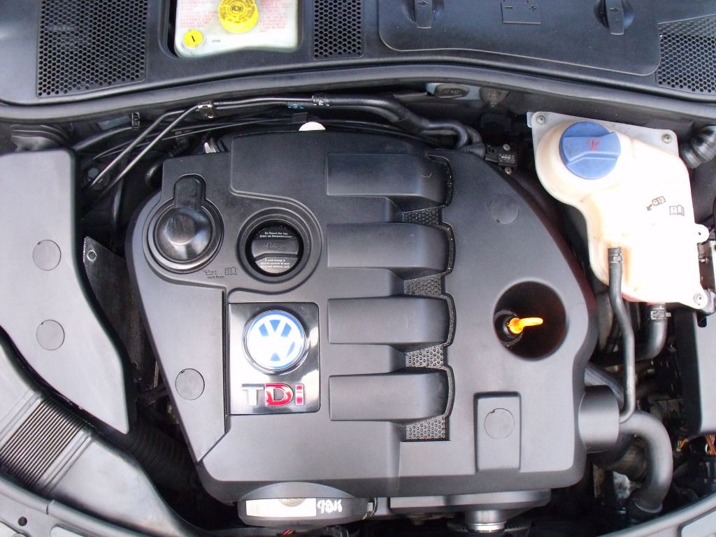

despite knowing the cars history i decided to give it a major service as it had 95k miles on the clock despite having fsh i wanted to play it safe as i intended to keep her & i like my cars to run 100%
so removed the whole front end
sorry for the lame picture quality this is the only picture i taken at the time
so ....
new cambelt
water pump
glow plugs
oil filter
the correct spec oil ( as im wasnt 100% sure what had been used previously )
fuel filter
air filter
pollen filter
aux belt
bottom pulley
tentioner ( as it was bouncing around )
fresh anti freeze
thermostat
temp sender ( as it always read a tad under 90c when fully warmed up )
battery
transmission oil
brake disc / pads
after all that we put it back together 3 days later i had a screeching noise while turing the steering wheel , i didnt have a clue i was thinking bad pulley , poor belt tension , pas pump going bad , after alot of internet searching , i finally came across the alternator clutch pulley , despite being told from various garages & motor factors that my car didnt have one only the newer models did , i did more research & alot of youtube watching i was convinced so went to a local vag discount parts centre & they confirmed the part so off i went a happy bunny NO more screeching :-bd

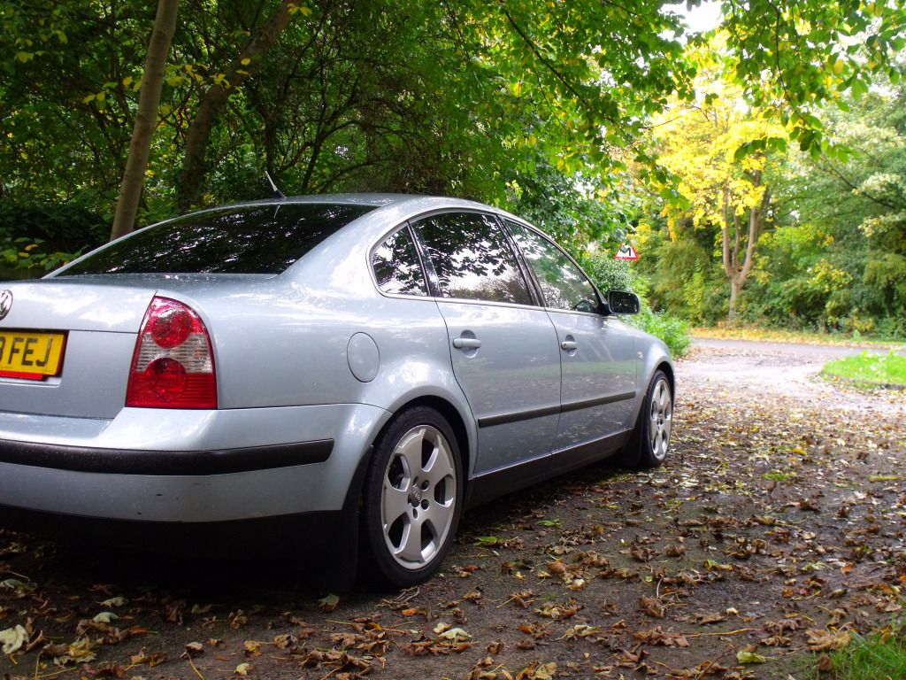

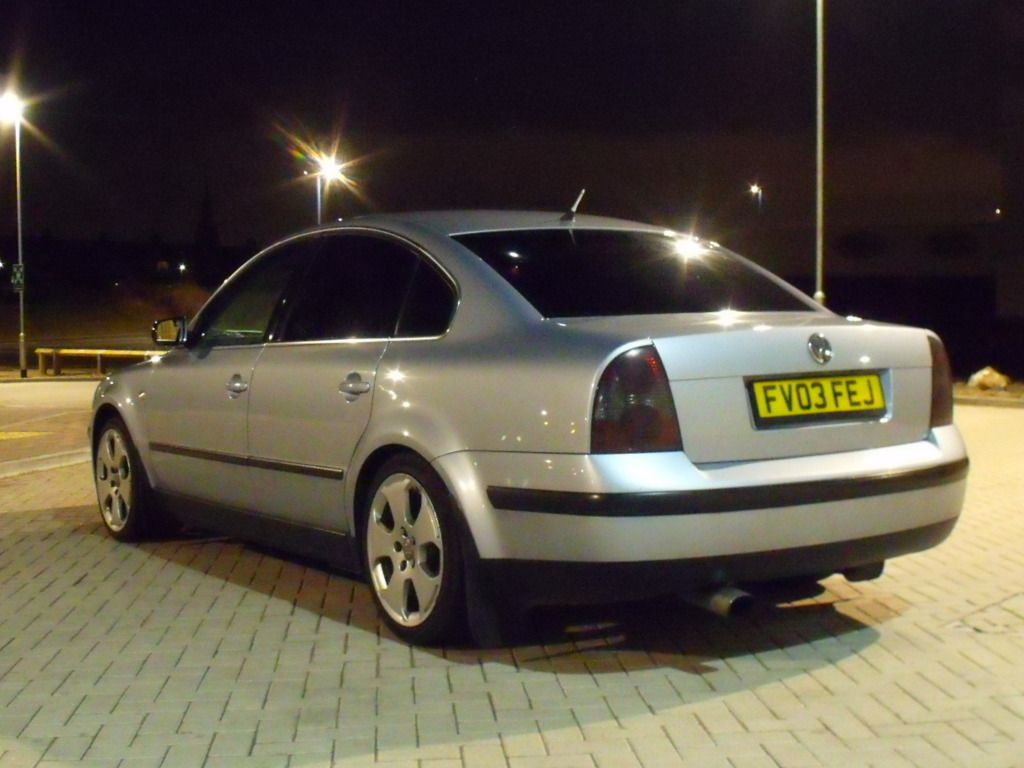

here she is all put back together & running sweeeeet! at the time this picture was taken i thought she stood out a mile looking all cool , now i look back & see a bog standard passat parked up ( must just be my love & passion for my cars ) :-

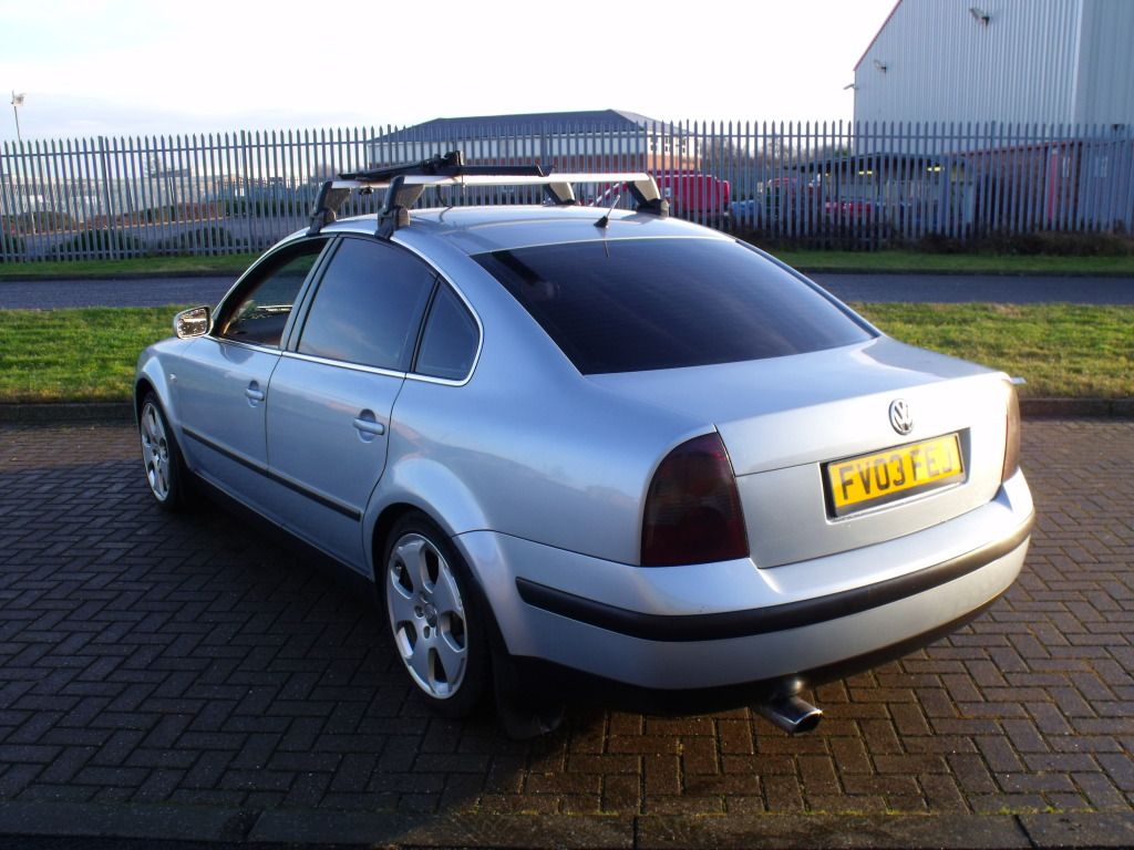

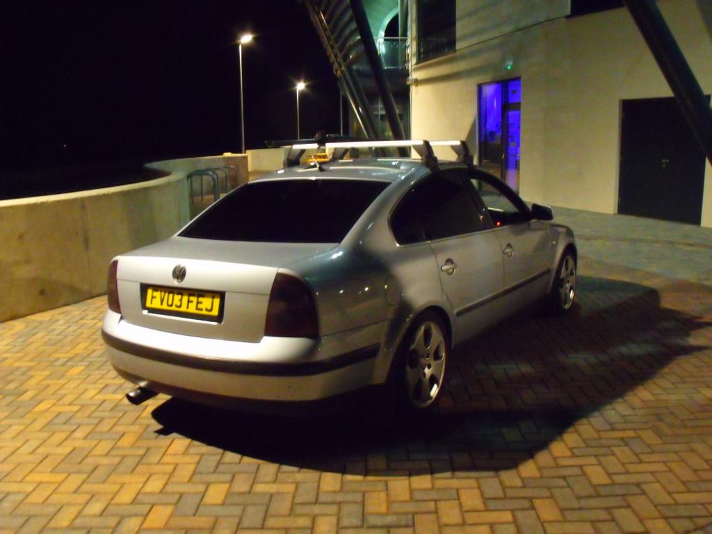

i soon realised i needed more room after taking my estate off the road & using the passat full time so bought some roof bars to allow my bike adventures to continue
then soon came the summer & taking the family camping was a nightmere as i like to pack every thing apart from the kitchen sink , i like my comfort :- so the roof box was a must

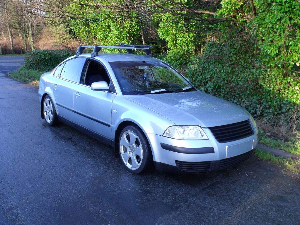

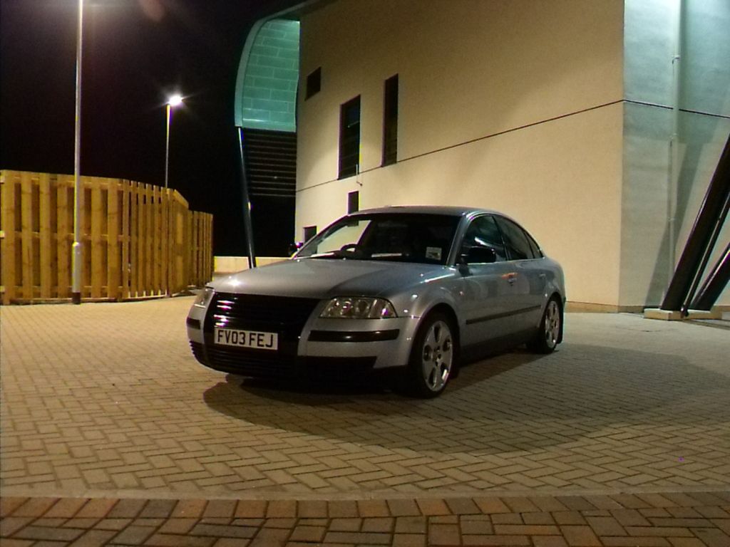

after studying the car i knew it either needed colour coding or adding a little more black touches to match the bumper plastics , side skirts ect , after phoning a few companys none had the correct colour match but were willing to order it in for an extra fee plus they said £22 per 500ml spray can considering i would need atleast 4 i decided i would add little black touches instead , how ever i added silver wiper blades / bee sting aerial
after a quick search on ebay i found a black fk badgeless grill for £22
i was on a roll so got the tints done from a friend 5% , after wards i added a black sun strip which i was debatable about ,

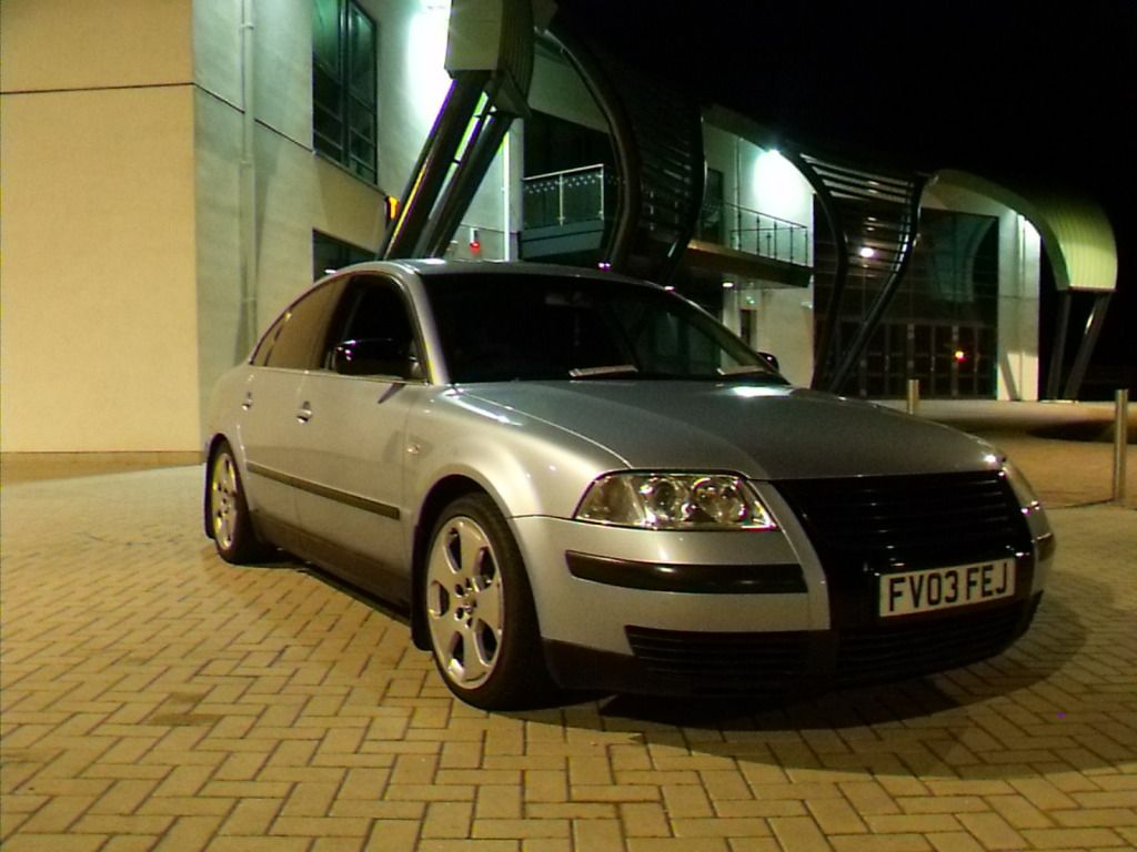

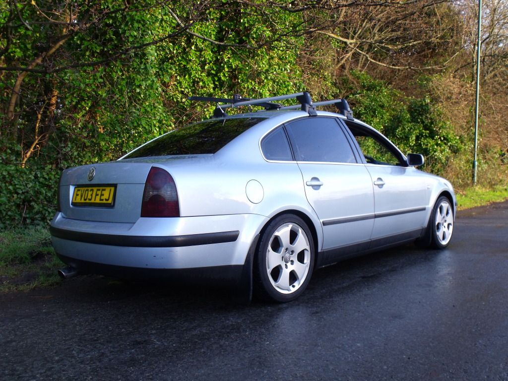

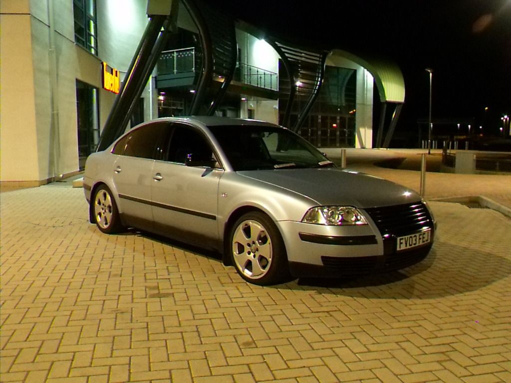

apex 40mm springs before & after pictures ....
now its sitting 40mm lower & the springs have settled for a couple of weeks i have ordered 20mm hubcentric spacers
x4 to bring the wheels out a little , only problem im experiencing is the mud flaps catch on ever thing , so might have to consider removing them , i didnt realise untill closer inspection alot of you guys have done the same :-?

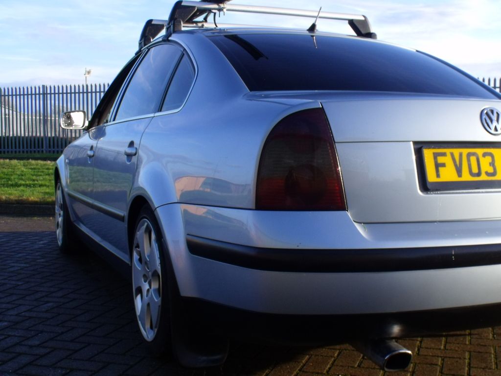

Spacers arrived yesterday
before & after shot with & with out spacers

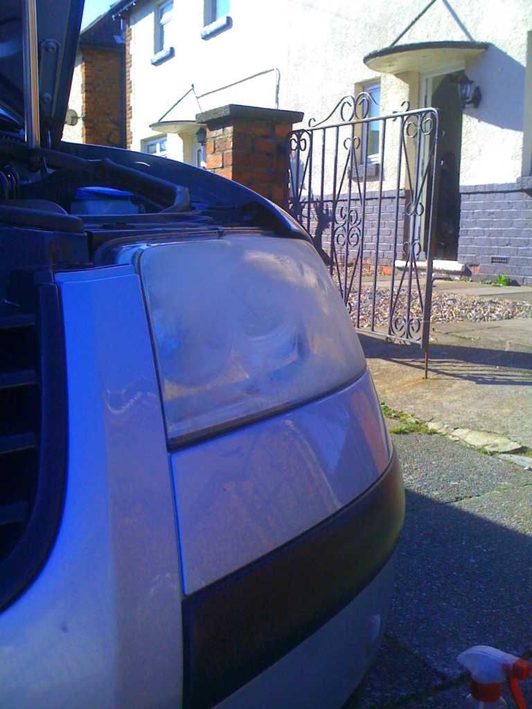

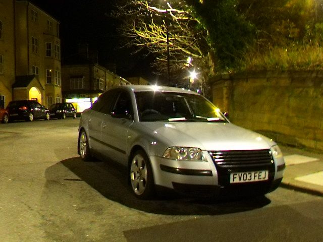

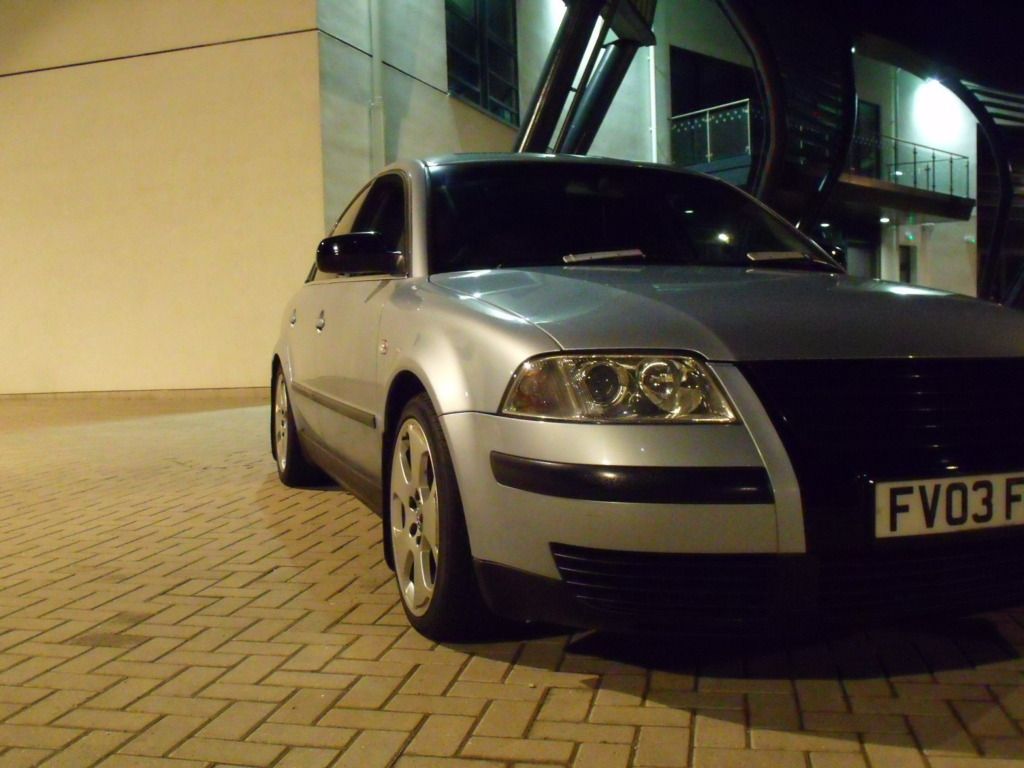

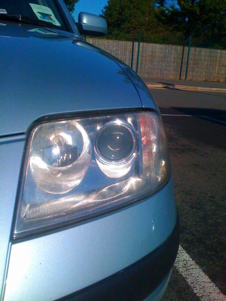

after doing alot of dark country lane driving lately I knew I needed to sort my passenger headlight out the visibility was so poor due to being tarnished over the years the plastic had scale like cracks with a smokey yellow haze , I thought to my self I have 2 options scrap yard or attempt my self with what I had to hand , after a quick internet search & myth's I went to work on it
Here's how it started
1st I covered the head light in tooth paste haha I know CRAZY but after working it in for 5 min I buffed it of to my surprise it removed yellow haze :)
Then sanded it with very fine wet & dry to remove the scales , then 20 min buffing in all kinds of products scratch remover , mer , aultoglem shine , waxed with some g3 compound
The end result .....
Needless to say I'm very happy at the moment saved me some money but let's see how much the light in improved tonight :)

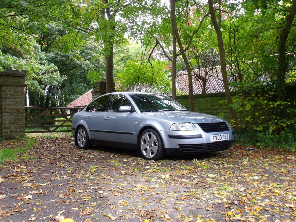

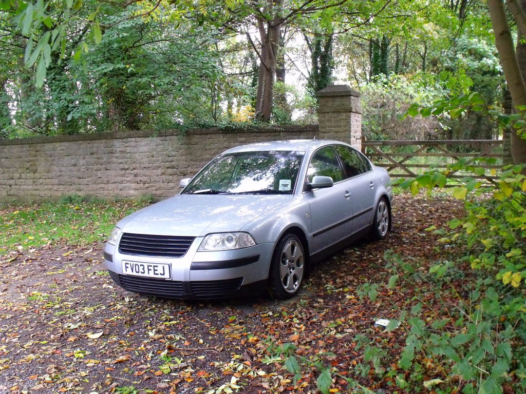

Seen as its a lovely autumn day out side thought I'd take a few shots of the sat out side the cottage

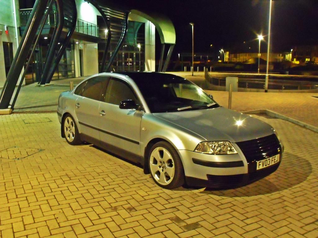

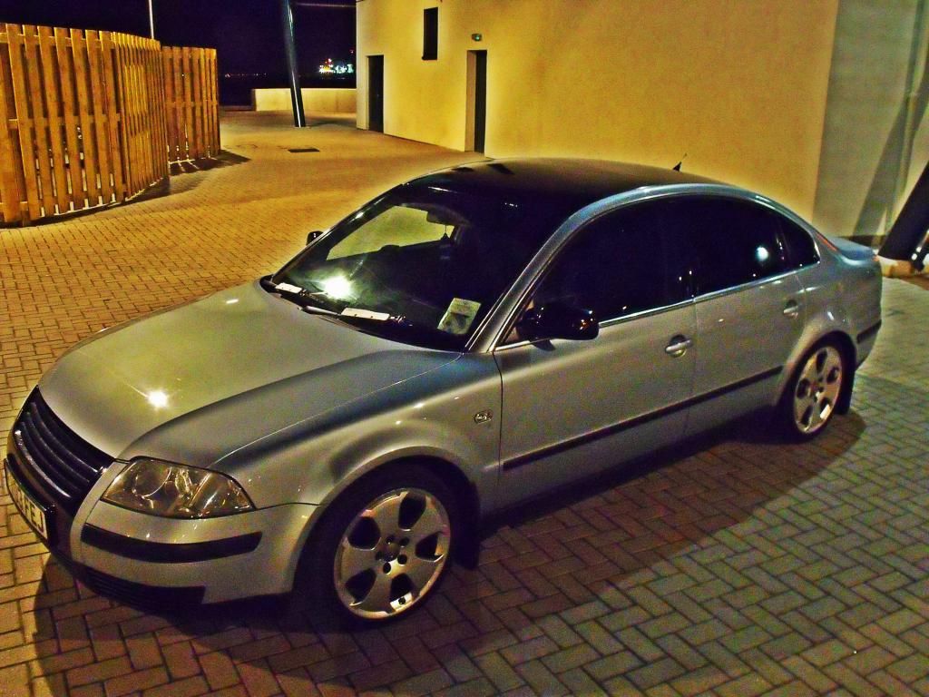

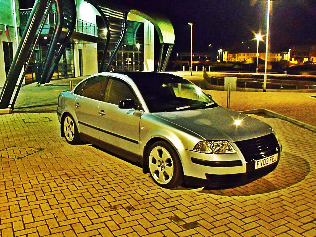

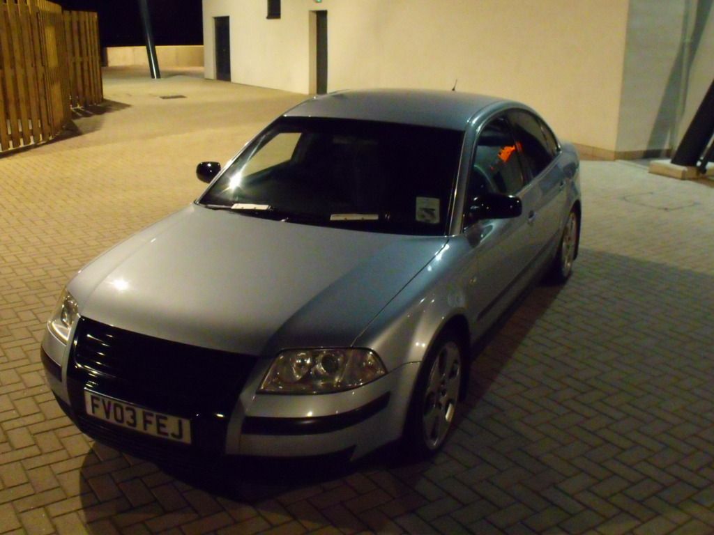

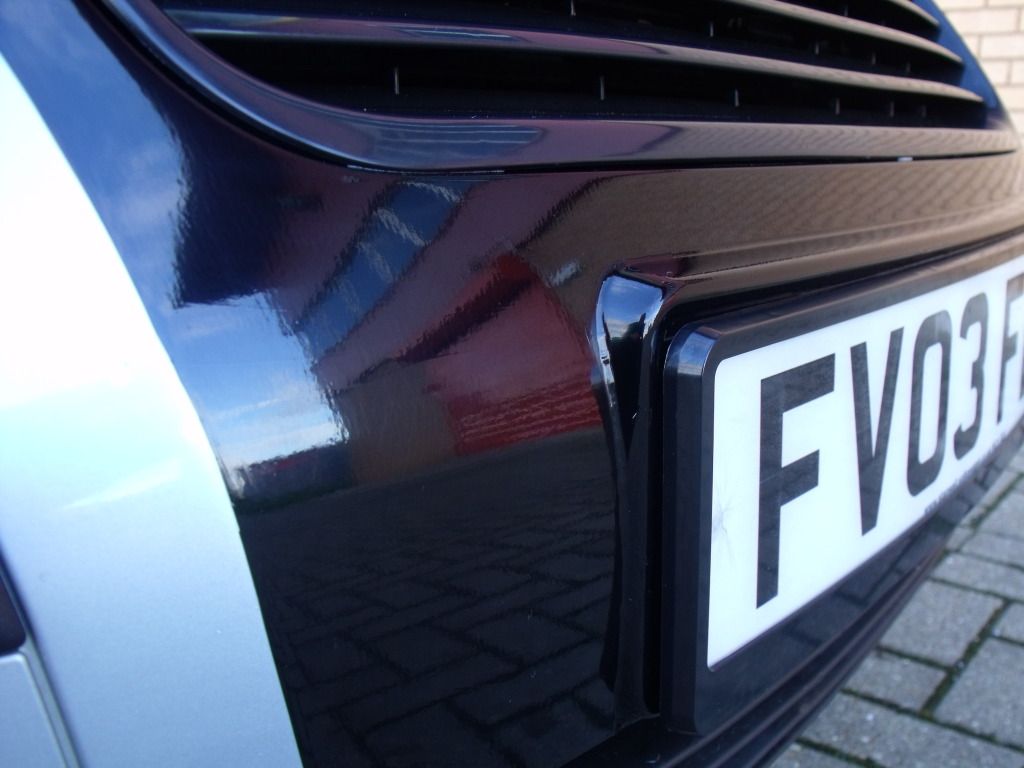

little update ..... grill / bumper & wing mirrors wrapped in vinyl , roof to follow next week end : )
feed back welcomed good & bad
i got abit trigger happy with the camera sorry guys : )
:thumbup:
thanks guys , im now looking for some US bumper rubbing strips if any ones knows whos willing to post to the uk?
very very nice Mike!!! cant praise enough. would you happen to have close up of the wraping job please? both bumper and mirrors? is it smooth or does it have a texture?
hey, the vinyl is a smooth gloss black , i havent got any pictures but will take some macro ones tomorrow for you ,
im also planning to spray the rubbing strips + skirts a gloss black instead of slicking them every few weeks , but i might hold of & see if i can get some US bumper moulds, ive also been looking at a front splitter to finish the front end of but it would have to a subtle one :)

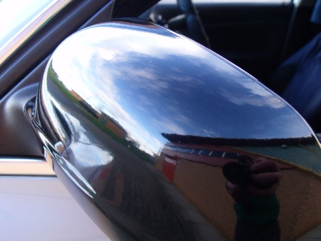

close up of the vinyl as requested ;)
also give it a good clean today including the forgotten areas
I like the vinyl. Any more pics that are not color edited? I want to do my roof in black this summer, just not sure if i will be able to afford it :(
heres the original picture ... i havent got many as weve had snow since this was taken but its clearing so will put more up soon : )
i would'nt have a clue what it costs you guys over there but i got the roof , front bumper , wing mirrors done for £100 i think thats about 150 dollars?
