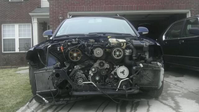

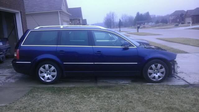

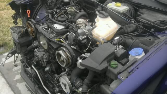

My buddy has a line on a Passat that needs work. However once I heard some stats on it it sounded unusual. It supposedly is a 6-speed car with a 3.6 liter turbo diesel engine, which I don't believe was offered in the states by VW. We did some more investigative work with the VIN, which said it is a European market vehicle. The trim letter was for the 6 speed W8 AWD, but the 4 letters that say the engine were all Z's which means undefined. There were a couple other fishy things with the VIN but I forgot what they were. More investigation shows the last owner was a german guy in Indiana. I guess there was a 3.6L diesel in the European A8 and Phaeton. You can see the twin intercoolers in the photo.
It was hit in the front and skipped timing so it probably needs new rockers or valves which isn't a big deal. Otherwise it is sound. Do we have some one off vehicle here?

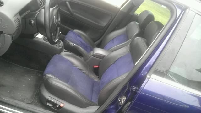

That is a 2.5 Liter Turbo Diesel, Alacantra Seats, OEM tinted glass, OEM Navi w/ antenna and probably TMC and TV Tuner, Full FIS cluster, Euro Hatch, Bi-Xenon headlights with auto-leveling and washers.
Interesting, are you sure it is a 2.5L? we were told it is a 3.6 liter but we can't really tell just by looking at it. Let me know what we should check so we can be sure what we are getting. Thanks everybody!

Its definitely a 2.5 V6 TDI, these are very common in europe, i drove one of these and they are pretty good also check the engine if you see engine code like these: AKN/BDG/BDH/BAU and AFB all these are for 2.5 V6 TDI. I dont think that there is any 3.6 engine in any passat..
PS. Autopics
There's a 3.6 gas in the B6 and the B7, but no 3.6 TDI as far as I know, ever.
Maybe it was a one off engine and it's even rarer? :icon_eek:
3,411 Posts
It is either a mid to late 2004 or 2005 model year Passat with the 2.5 liter V6 TDI engine. You have a possibility of 3 horsepower levels, 150 (110kw), 163 (120kw), or 180 (132kw) depending on which engine is installed. You should be able to look at the option sticker in the spare tire well and determine which engine it is as engine code and power rating will be listed. AFB/AKN=150 hp, BDG=163 hp or BAU/BDH=180 hp. Considering the model year I would say it is most likely the 180 hp version.

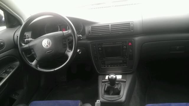

Is it a 4Motion? From the looks of the gear selector it almost appears to have the 4Motion logo on it.
If it is able to be put back on the road it is a torque monster.

There was never a 3.6 liter diesel engine in a Passat.
Looking at the post on myturbodiesel.com the operator manual is under the steering column and should also have the option sticker inside of it for further information.

Thanks for all the info, its going to help a lot. I guess the cams were shot so we are getting some new ones and rebuilding the head. It should be back on the road in a month or so. I'll keep this thread updated if we find more info. My friend might drive it for a while or sell it once its done so keep an eye out if you want a rare german luxury torquemonster. :D
