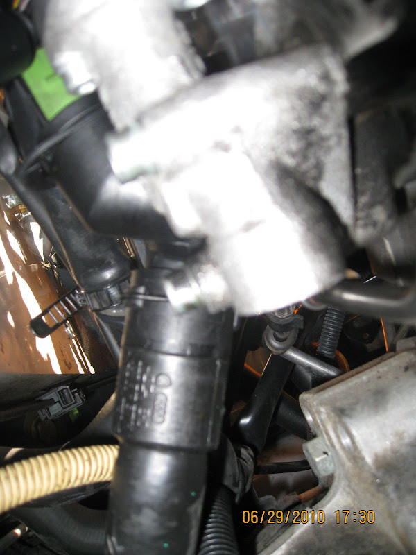

(3) Remove two 10mm bolts connecting upper coolant pipe to the flange. Working from driver side and use some wobble extension. This step is easy.
loosen one 10mm bolts holding upper coolant pipe next to the frontmost intake spoke.
I broke a plastic bracket in my past “gentle” work which is replaced by a green zip tie below, now I just cut it to allow some movement for upper coolant pipe.

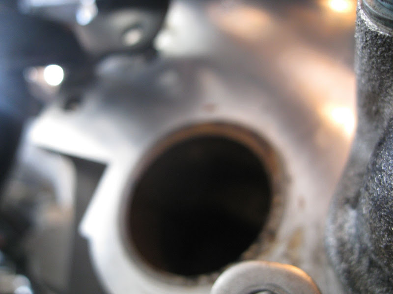

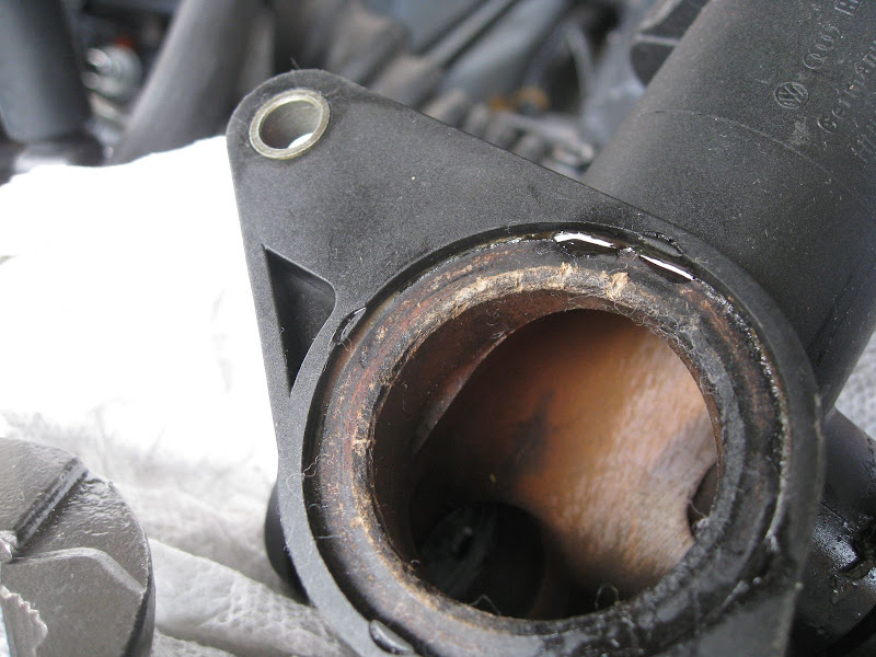

My old flange has no crack, but for the reason that its design does not hold the engine block o-ring securely, I would not reuse it. (plus mine is 9+ years old)
The key to a successful installation is to absolutely make sure each and every o-ring stay where they should be. I might reuse and return the new part back to my local dealership if I have following design on my flange.
edited: another important thing as PZ kindly points out - "clean the back of the head before replacing the flange... Any dried coolant left there will cause the new seal to leak". I used a piece of lint-free cloth to clean the area and inspect it carefully before proceeding to installation. If required, you could use fine grit sandpaper and give it a quick cleaning as PZ suggested. Installation is the reverse of removal but since in this job it probably will take longer so I spell it out for mental comfort. (7) If you get a new inlet hose o-ring, remove the old o-ring, and seat the new one inside the hose. Wet o-ring with diluted had dishwasher detergent/soapy water (or for that matter just G12+) would help installation. Push new flange into inlet hose. Secure with its metal spring clip. Unless you are able to do flange swap in place, wiggle coolant flange back to its neighborhood pay attending to your specific piping / wiring arrangement. My inlet hose goes below the yellow wiring
(8) Wet and put o-ring over the rigid upper coolant pipe. Review comment and picture in step 5 above. Get flange to seat flush on the engine block and push two together to seal the connection. This way if the o-ring is not seat correctly, it will be push out and you can see and feel it. put on both 10mm bolts there loosely, as long as the o-ring is kept inside the connection. You want those bolts a bit loose for jiggling the flange in following step. (9) Install the lower flange bolt. This step take anywhere between minutes and hours depend on luck, karma or alignment of planets. Remember to push away the turbo line, use your inspection mirror to help jiggling and alignment. The bolt has a flat tip (instead of slight tapered tip of other bolts) which is really a pain. If your luck is not so much in your favor, using your right hand to pull the flange away from the block for ~1mm might improve the six sense of your left hand, which is holding the bolt and trying to thread onto engine block. If succeeded, snug tight (I mean, still allow room to jiggle). (10) Now the upper flange bolt. It is easier now since the alignment is nearly in place if not perfect. It helps that this bolt has a normal tapered tip. The challenge is how to deliver it. I end up use electrical tape to hold it on to my 10mm deep wall socket and deliver it using my left hand. Outside wrapping for better friction.

I would like to ammend steps #9 and #10, which in my case proved to be the most challenging part of all the DIY.
The easiest way to do this IMHO and as I did after many hours of frustration is to ditch the OEM bolts that secure the flange and to replace them by 2 pcs M6 studs with allen edge.
Then, when the flange is removed for "o" ring replacement, and the space there is already big, u have to insert those studs I mentioned in the holes of the bolts and tighthen with the small allen key.
Then when the time comes to install the flange, u simply slide it over the 2 studs and use 2 nylock nuts to secure it in place.
The lower stud should have at least 40mm length to allow you to slide on part extending beyond the nylock nut the bracket for the oil hardline.Then a second nylock M6 nut will secure the oil line.
All these can be done with the eyes closed.
If OP agrees, these paragraphs should be kept with the write-up which is excellent , anyhow.
This may work on the bottom hole (passenger), but the at least on AUG and later engine codes, there's a bracket involved. Bolt goes through bracket, flange, then into block. No way to get the flange on with the stud threaded in before the flange is in place. Probably can't do it on the lower hole for similar reason. Wouldn't be able to angle the flange over the top of a stud in the lower hole while sliding the flange behind the bracket for the top hole. If the bracket isn't essential and can be cut off or removed, it could be possible. I'm going to look tonight.

I've replaced the coolant flanges on two 1.8T's - a 1999 Passat AEB and a 2002 Audi A4 AMB. Both of them were a royal pain to do. I do recall that the O-ring on the 99 Passat between the flange and the block had basically turned to mush and needed replacing. The O-ring on the coolant sensors for both flanges were definitely bad.
In retrospect, I would replace just the O-ring on the coolant sensor and then monitor the coolant level to see if the leak persists. If it does then you'll have to replace the flange and O-ring. I suspect that the sensor O-ring tends to leak more often than the flange to block seal. The O-ring on the flange to block interface for the Audi looked to be in fairly good shape, as opposed to the one on the Passat. When I jacked up the car, coolant literally streamed out the back of the flange, which leads me to believe the problem was with the coolant sensor seal.
If you can get away with just replacing the sensor O-ring then consider yourself extremely fortunate. Don't put yourself through the aggravation of replacing the coolant flange unless absolutely necessary.
I believe original flange actually had the lip to hold o-ring, it simply disintegrated over time since it is in direct contact with the block. Mine still had a lip on about 2/3 of the circumference, presumed that was reason for my leak (and fact that o-ring was a gummy worm). With slightest pressure, a small piece of the lip broke off.
So, good thing you filtered the G12. :) For others, probably best to go ahead and replace G12 if that lip is partially/completely gone since the pieces are probably in your old coolant.

I also suspect the original flange has a inner lip to hold the o-ring (although it is complete gone on my 2001 AUG, but Doyles has proof it exists).
Think about the wide range of temperate and pressure change these seals have to go through during a driving cycle - that particular design weakness (with inner lip MIA in old age) also explains what myself and others observed: the coolant tends to leak a certain fix volume at some particular coolant temperature or coolant pressure.
