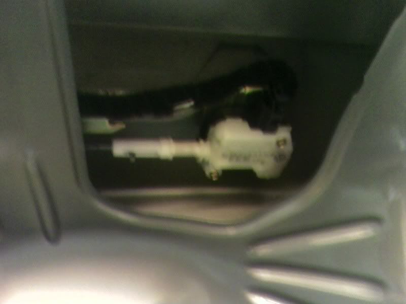

So this thing broke..
It's the lil Electronic Doohicky that pulls my trunk latch release when i hit my key fob..
I think i need a new one.. cuz it just makes a crappy noise and does not work.
Thanks

The little electric motor in mine shorted out and blew fuse 14 - the ccm fuse - which also controls the security for the car. Because this fuse was blown, the relay that allows the car to start was not engaged and I was left stranded.
I got a new actuator at the dealer for about $50.00 part number VW 3B5-827-061-C
You have to unbolt the bracket that holds the lights for the license plate. I ended up not removing it from the trunk lid, but just rotating the bracket around so I could get to the screws that hold the actuator to the bracket.
Replace the old one with the new one and you are good to go.

well.. mine stays in place when i hit the button..
So i know it's not just moving outta place.
Also. fuses seem good.. it just Groans when i hit the button and doesnt actually do anything.. if i pull on the wire that it actuates. the trunk pops so i know it's not broken there.
I think the thing just failed is all and won't pull anymore.
