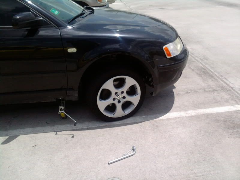

so my buddy finally got his rims and took off the ones he's selling. We popped one on my car just to see how it looks. His tires were uninflated so we didnt lower it all the way.. have a look, tell me what you think.. oh and im deffinately going to need spacers, his tire is too wide. Does anyone know how much they run for? or where I can get them?
you can see where it touches that whatchamacallit there

OH there denvers not Huffs!
those are like offsets of 47?57? i think?
Idk for sure, test fitted some on my b5 and they would be a pain to get to mount so he sold em ha
edit: its not his tire, its the offset of the wheel.

15mm at least. Need longer bolts too. They go for about $50 per pair and idk about the bolts $$, but you need ball seat ones. Check ECS. Add 15mm (or however thick the spacer is) to your stock length to find the ones you need.
It will fit with spacers. but your gonna need roughly $300 to get em to mount up and go, Spacers are yeah roughly $50 a pair... bolts will run you another $80 or so for extended ones..
ecstuning has em, raderworks, and Black forest industries
if your heart has a sweet spot for these then go for it... but hope your wallet can fork over a few hundred more to run em.
