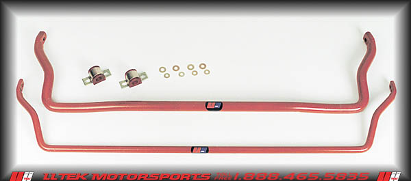

Can I put these (cross-tower brace & anti-roll bars) on

Probably not ... the Strut tower brace only fits early model B5's. You are better off looking into the A6 tower brace, it requires some modification but it will fit. When I say fit, I mean clearance of some key parts.
No Audi bar will fit ours. Spoke with LLtek and they told me.
For Upper strut go for 4point from Racetek, SPP is selling them.
give a call to Eric Nareshni www.supremepowerparts.com
For Anti-sway, front one go to www.Autotech.com and check their 32mm front hollow (for FWD and AWD is same Part#) bar.
For rear sway bar go to local VW and check their rear sway "sport 1BE" 17mm thick (against 15mm stock) Part # is 3B7 511 409 .You need either to order from VW separately bushings (rubber one) for this bar or buy aftermarket bushings from PolyUrethane (I did PUr bushings,just choose same size and inner diameter 17mm)
All this I put on my 4Mo V6
