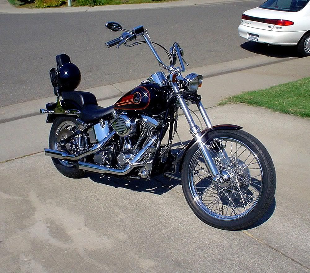

To this:
Did all the work myself (aside from a few machining tidbits). As you can see...she still needs some work, but she runs!
I like that a lot. Well done! :thumbup:
How many burns do you have on your right leg? :)
