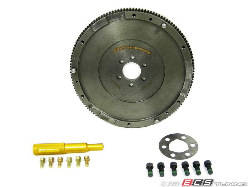

668 Posts
Correct since the S4 clutch is 240mm vs the stock size which is 228mm.
ECS flywheel is also very thin and looks to come with a spacer that goes between the flywheel and crank flange.
CM also offers a 240mm clutch/flywheel kit for the longitudinal 1.8t, it comes with CM's 240mm S4 2.7t clutch kit.
