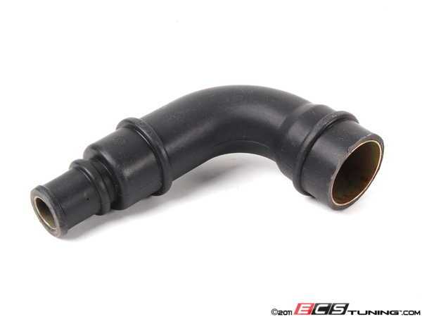

my 2001 1.8T AUG engine is due for its first ever PCV system maintenance.
I found a cracked L breather tube.
Although it is possible the crack was resulted from my brute force to remove this thing (both my breather tube and orange engine oil dip tube broke into two piece), I am inclined to believe that the crack has been there for at least a couple of years.
BTW, how do you guys remove those one-time VW clamps? I use rotary tool to cut them. But when it cut through the clamp ear, a few of clamp has a half of ear fall off and disappeared. I hate to have broken parts disappear on me - don't know where they will end up (don't like they landing on some moving parts - axles, transmission, differential ....)
Should I really be worried here?
Do you guys replace VW clamp with generic hose clamps? any recommendation for where to get them?
With all nasty sludge in the L breather tube, I guess my PCV valve has clogged/failed (although I don't know how to test it) for a while.
The crack on breather tube explains
(1) I never really see a high pressure building in my engine (no wooshiii escaping air when I open my engine oil fill cap while engine is running)
(2) dripping oil from the driver side of my 1.8T engine (the oil trace actually starts from above my oil cooler/oil filter housing which is where the above L breather tube goes into)

What is the part number of that breather tube (#2 in schematic, cracked item in top photo) for AUG? I see lots of "AWM only" and similar listings on ECS and Partsgeek, but no AUG listings anywhere. Is the same part used across engine versions, or did it change along the way?
Looks like the current AWM part number supersedes the older ones and is standard fit for an AUG, too:
Vent tube. Volkswagen (VW) # 06A103213F
We have a few listings for #2 band wise - If you are looking for a full refresh kit we have that available too!
