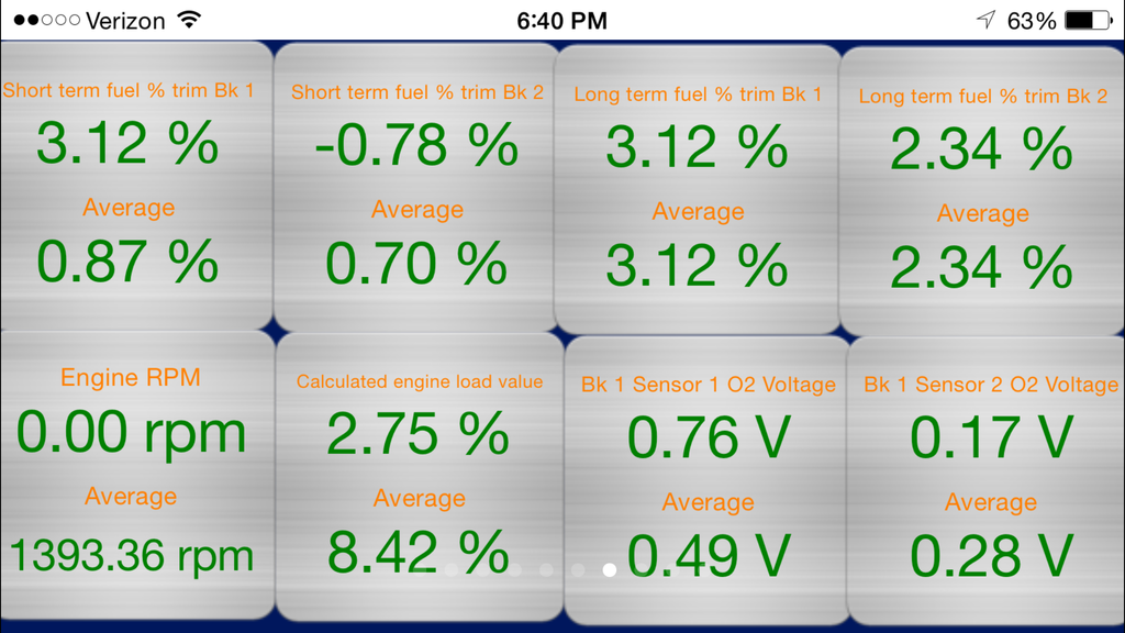

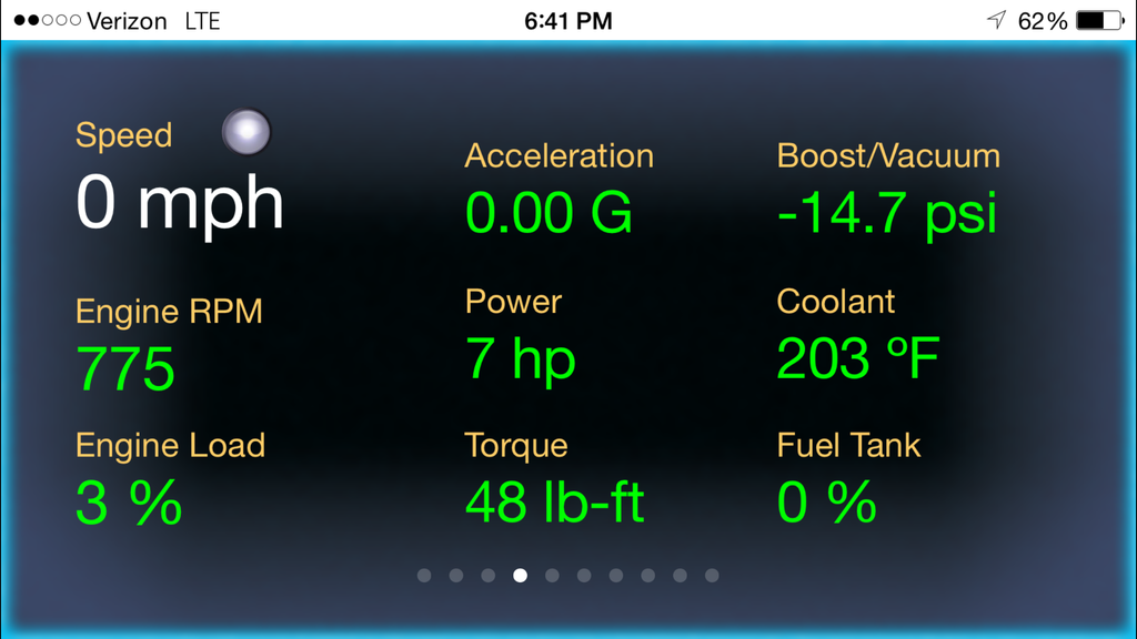

I took my car on a drive for 15 minutes and these are the levels I got. Max speed I went was 45-50 mph. It's a 2002 V6 ATQ
I surprisingly haven't had a check engine light yet and my secondary air system has been "complete" according to the OBD II

Yes, everything looks within spec. The biggest items I looked at were Long Term Fuel Trim %, Short Term trims, and throttle angle. Trim values should be + or - 10%, not exceeding those ranges in either direction. Yours are pretty low and don't raise eye brows. Throttle angle is sitting at a reasonable value. Additionally, engine idle speed is within the FWD spec (680-800 RPM,) and engine temperature is within its proper range. All the green COMPLETE values on the last image indicate that those systems have passed the OBDII "Readiness" tests that emission testing inspection places usually check. The car is able to take readings from multiple sensors to come to the conclusion that those emission components are within spec of the manufacturers design.
All the other information changes in real time usually, such as O2 sensors, mass air flow sensor reading, engine RPM, engine load calculation, etc.
