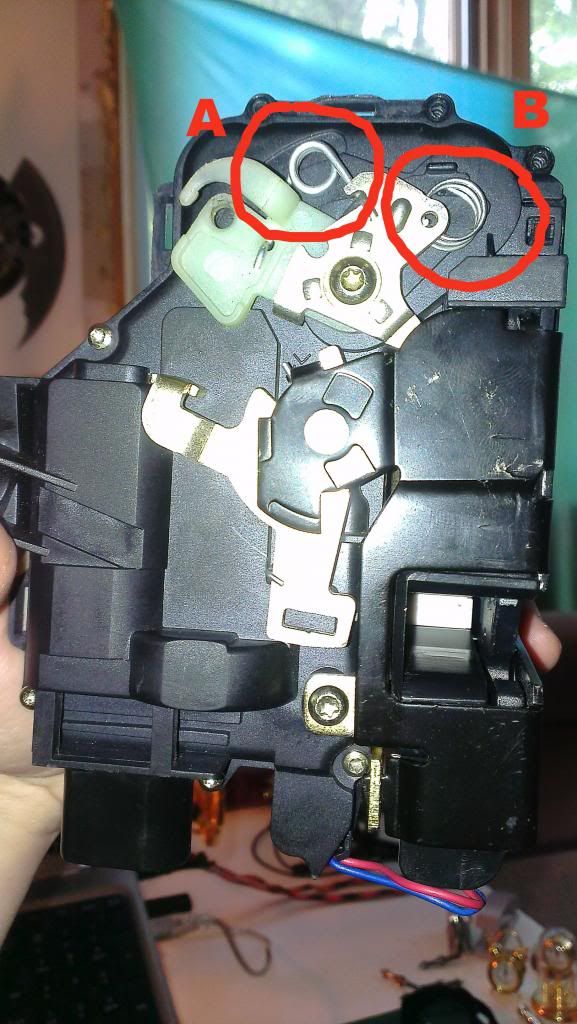

Your problem may be the over-center spring, which works the same as a toggle-switch to keep the latch in the lock or unlock positions. It's about 1/2" outside diameter, maybe three turns of wire. One of mine broke, and that door's knob would indeed bounce back up, unlocking one door when the others were locked. I just copied the spring using appropriate steel piano wire, and solved the issue.
Do you mean one of these by any chance?
Yes, spring marked "B" looks like the one which was broken on my passenger door latch. I don't remember a hefter "A" spring, but inspect those if you can.
Great, I'll just switch over the spring from the crappy module. Seems like an easy fix
