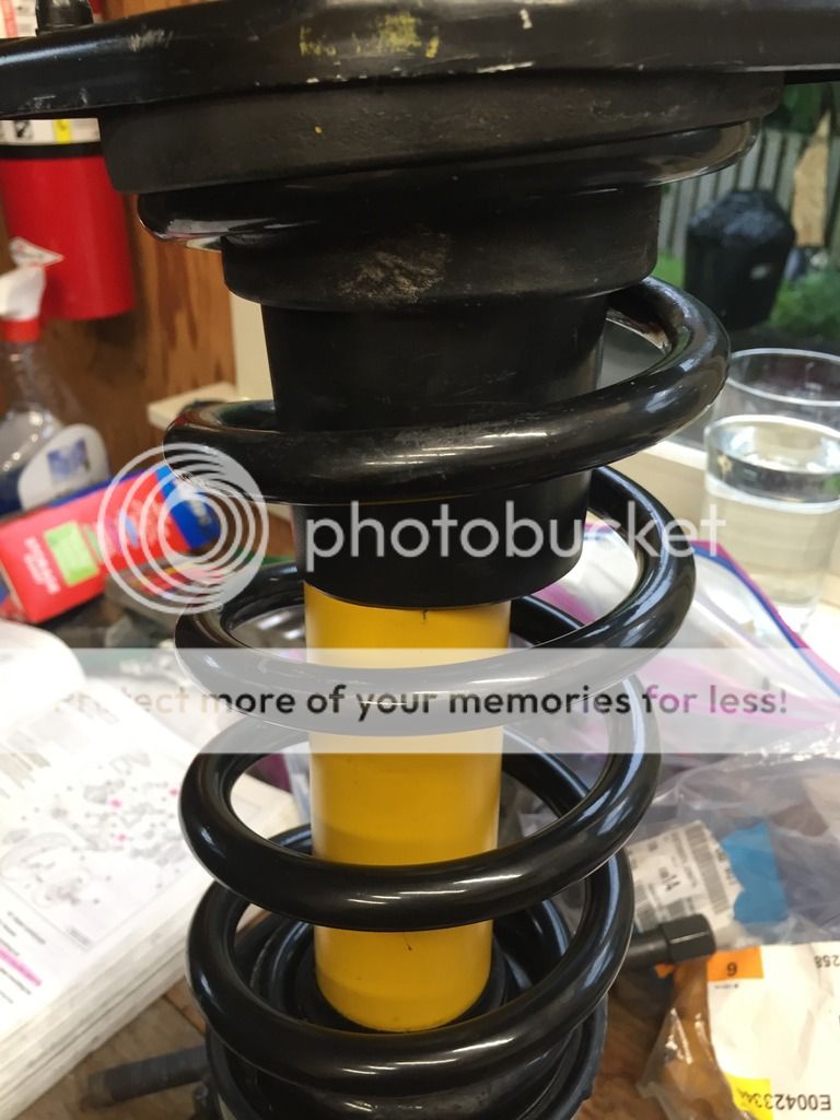

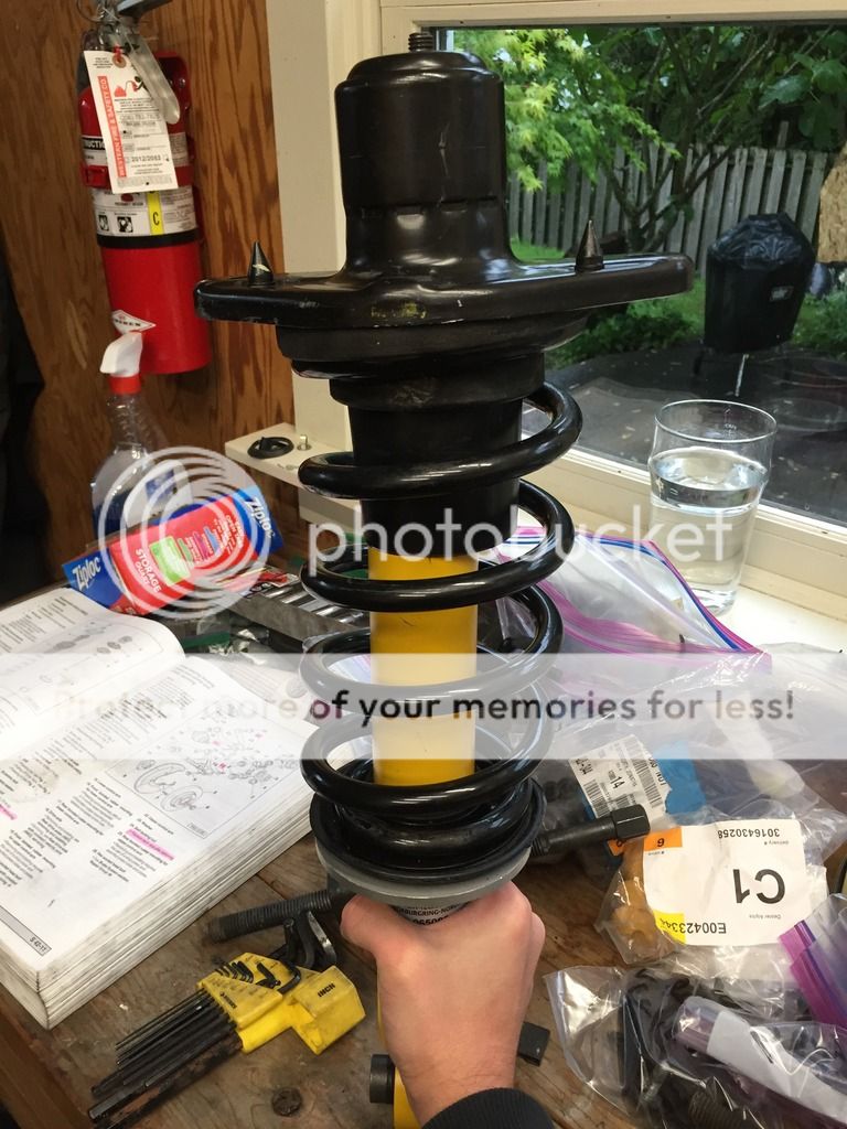

Quick question for those that have done the rear struts on the 4motion. I've re-assembled my first strut, but the 'hat' is sitting a bit cock-eye'd. Is that normal? Or is the hat tweaked? I can't remember what it looked like when i took it out of the car. :/
You can really tell when you look at the strut sleeve relative to the strut:

So I got the struts back in the car, and you guys were totally right. If I had been paying attention when I took the struts out, I would have seen there is a tilt to the hat/car interface that you need to match with the way you built the strut back.
To get the correct hat orientation when the strut is re-assembled, orient the spring thusly:
Right side rear: Lower spring end points IN towards center of car
Left side rear: Lower spring end points OUT
