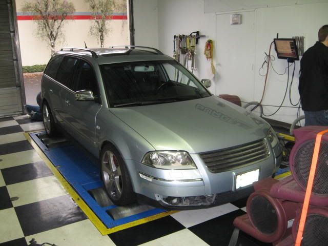

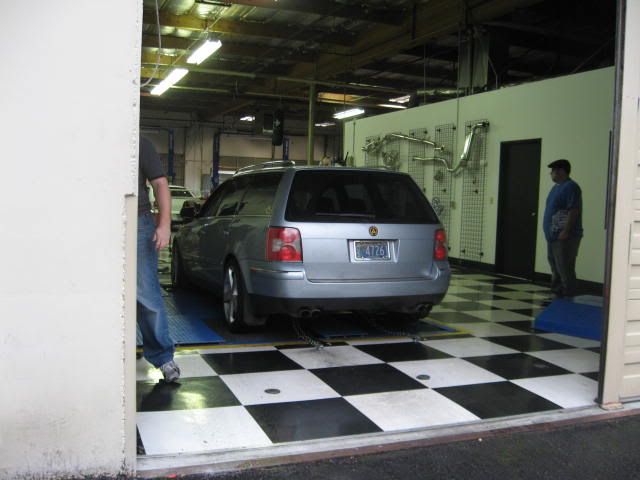

Today I made it out to Surgline Tuning in Tualatin, Oregon, to get my car on their AWD dyno. I recently added a custom Magnaflow cat-back exhaust, an Amsoil cone filter WITH a custom heat shield :))), and ECU software remapping.
So, I went and made some runs, just for kicks. Many thanks to Tim, Brandon, and Travis at Surgline- they really know their stuff!
Anyway, here are the results. Please chime in with your thoughts and observations.
254 wtq
224 whp
AFR 15.8
Am I too lean?
