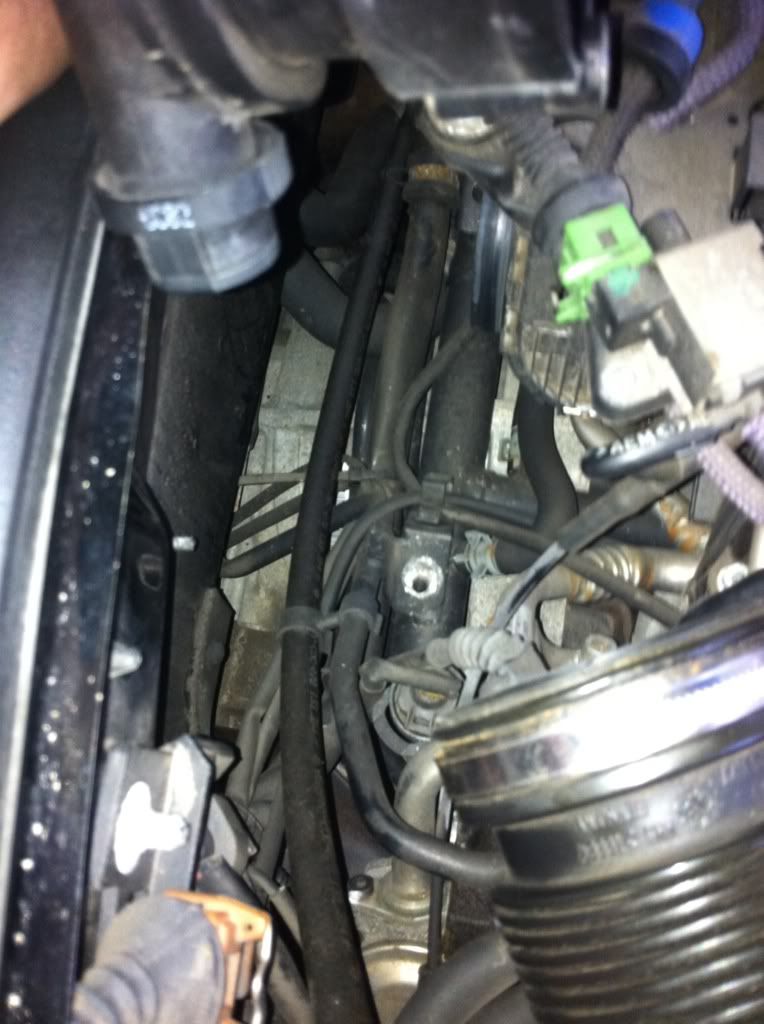

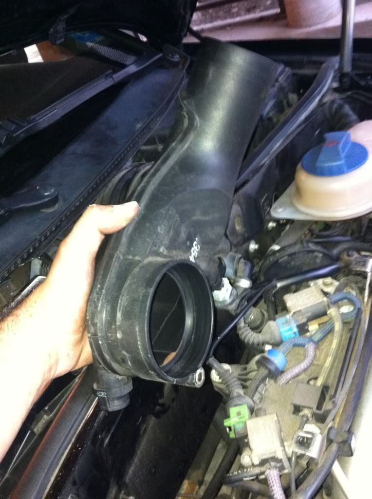

Not sure exactly what you need to see but have two pics on my phone that may help. These are from when I was going through the pain of changing my Coolant temp sensor.
First one is after the air intake behind the engine was removed.
Second one is loking down behind the engine from the passenger's side, where the CTS is located.
If anything more detailed is needed I will take more pics when I can get to the car.

this may help you out.
the blue lines are what you need to look at, they Tee off right near the blue solenoid.
this is so you can see where they come from and where they go to. yours will look different and I am sure you understand what you are looking at. If not ask away.
