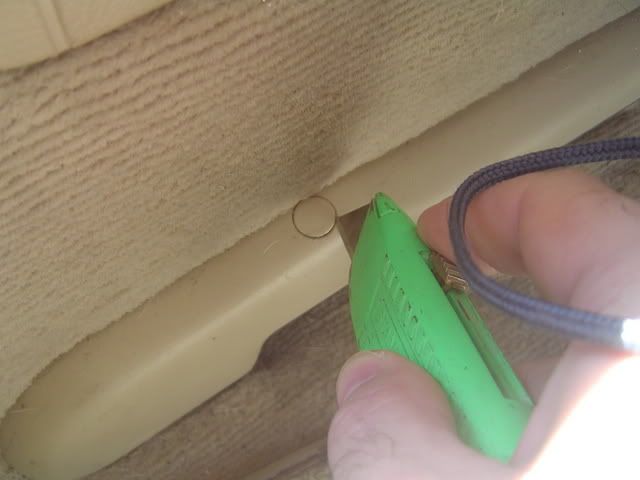

Next, slide the seat all the way forward. There are caps pressed into the plastic rail guards. Pop them out with the tip of a knife, remove the screws and then remove the guards.

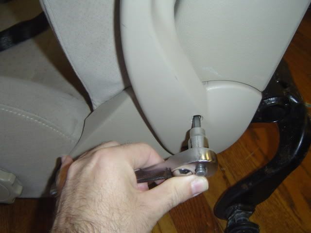

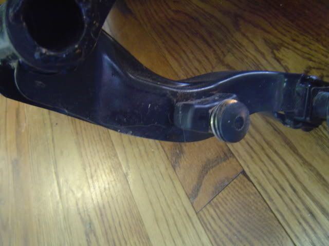

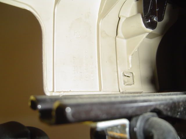

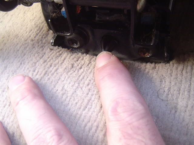

Slide the seat all the way back. See the picture below. There are either two screws or two nuts depending on the model year. Remove the screws and then squeeze the nub between the screws and push it through the hole:

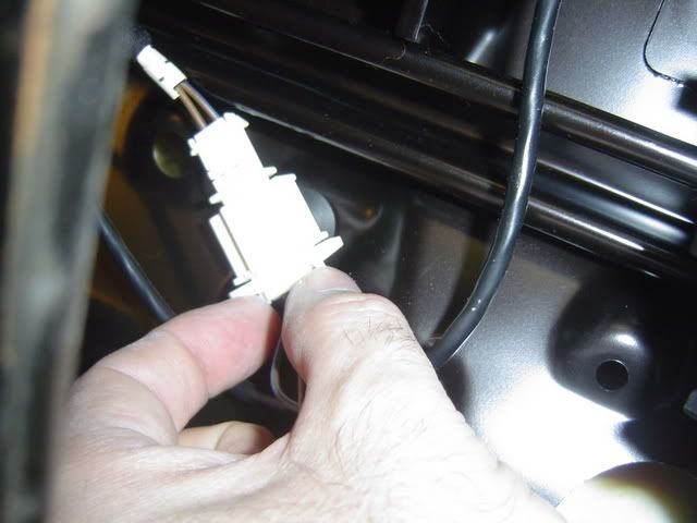

Tilt the seat back for easier access to the connectors. Disconnect all the connectors. I think they only go back one way, but you may want to label them. There is an xmas tree like thing that holds the harness to the seat. If you can't push it out from the back, work the other part out from the wrap and cable tie it back on when you re-assemble.

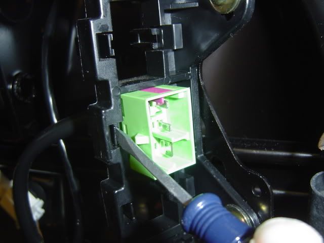

Remove the connectors from the frame under the seat using a small screwdriver:

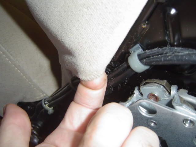

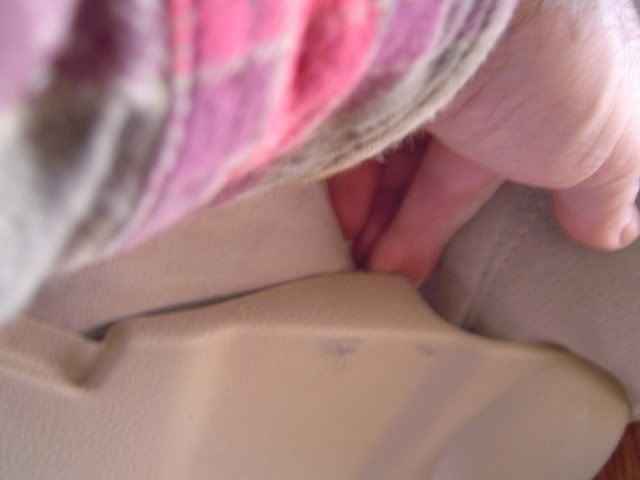

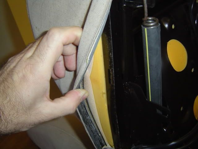

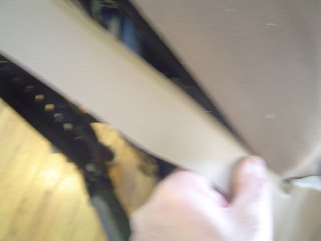

On the side of the seat, find the spot where the seat fabric begins to be attached to the seat frame. Stick your finger in there and pull down:
Once one end is out, keep working around the front of the seat until you get to the other side. (I still have my spring- HAHA!):

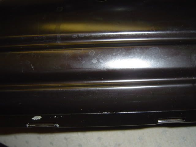

Once the sides and front are free, pull up on the cushion. No, it's not glued down. Your fat ass has been pushing down on it for so long, it stuck to the base.

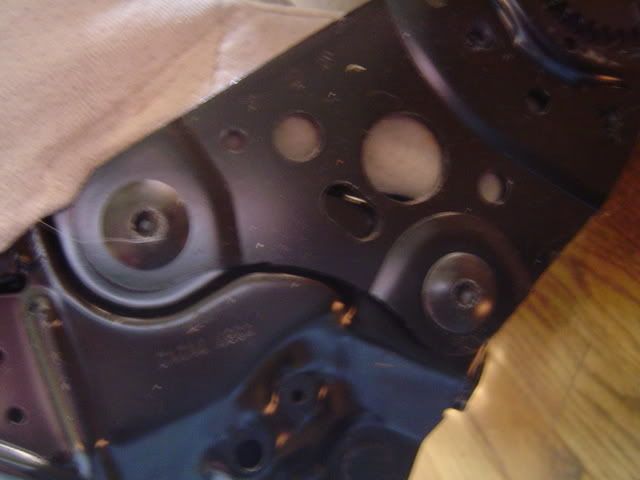

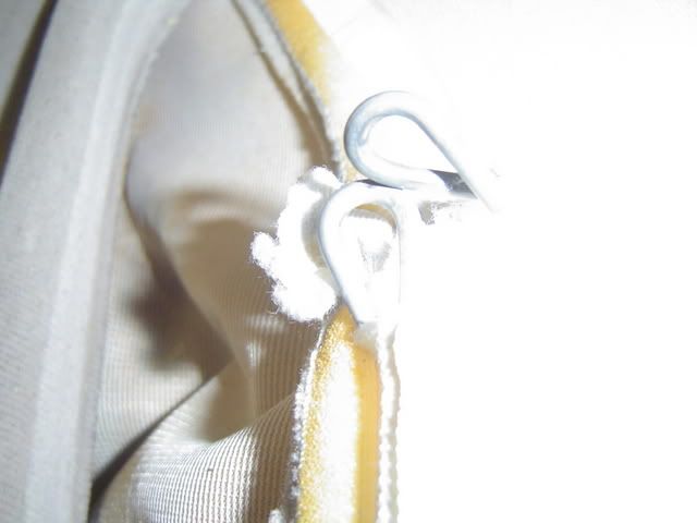

Not sure how to explain this, but flip it upside down so that the base points one way and the cushion the other way. Lift up the cushion so that it is 270 degrees from how it normally sits. This will give you access to the back clip. It may fall out by itself, or you may need to pry the back clip open a little. Here's a picture of the back clip in the seat frame. Note the teeth that bite the trim strip on the back of the fabric:
Your cushion is now free. Peel off the fabric from the edges. The center is held on by bars sewn into the fabric. Loops at the end of the bar hook around wires molded into the cushion. You'll need to grab the bars and work the hooks off the wires. If needed, bend the hooks open a little:

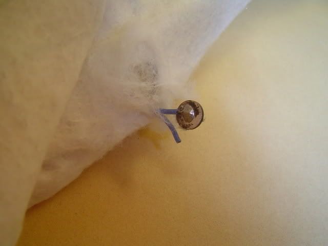

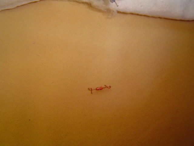

If the sensor is bad, it's most likely from a broken solder joint. The ones that VW used are wafer type and can be tricky to solder. You may have better luck with a leaded type. One member had to buy a whole boatload of them. If he gives his permission, I'll add his username so he can send you a few (Look two posts down).

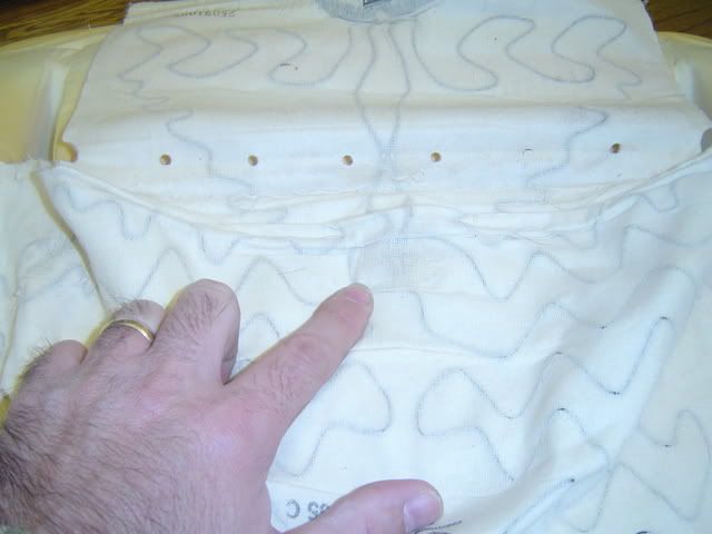

The sensor is located here. There is a reinforced area in the cloth and a lump you can feel from the back:
You'll need to dissect it out from the back. Be careful not to cut the wires. Once free, you'll be able to pull some slack through for room to work:
If you feel comfortable resoldering the thermistor, do it. Otherwise take a leaded thermistor and form it as shown:
Slide some shrink sleeve on the wires and solder the sensor in place. Here's what it looks like when done:
Tuck it back into the heater fabric by pulling the slack out of the wires. If you check continuity, it may show open. Themistors have wierd electrical characteristics. Turn the meter from autorange and eventually you find a range that shows resistance.

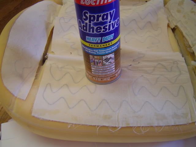

Now to reattach the heater. Note that it is only glued at the back, front and sides. The center floats. Leave enough slack so that the heater can go into the two slots in the cushion. You sould be able to see the old glue stains. I used Loctite spray adhesive from a fabric store, but you can probably get it at a home center too.
