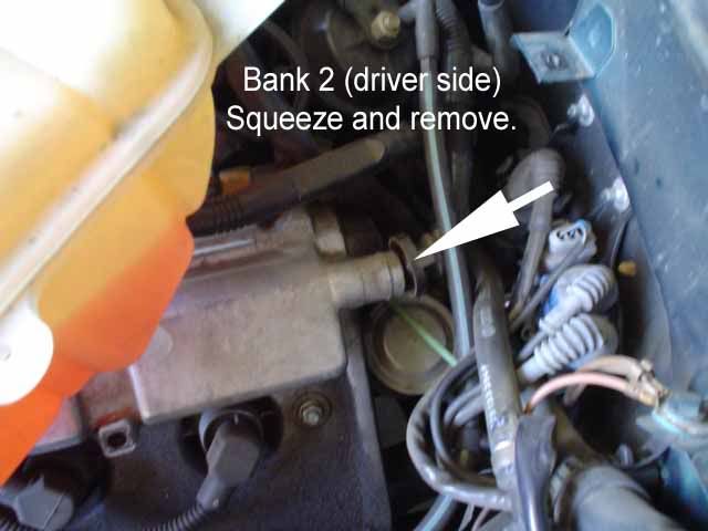

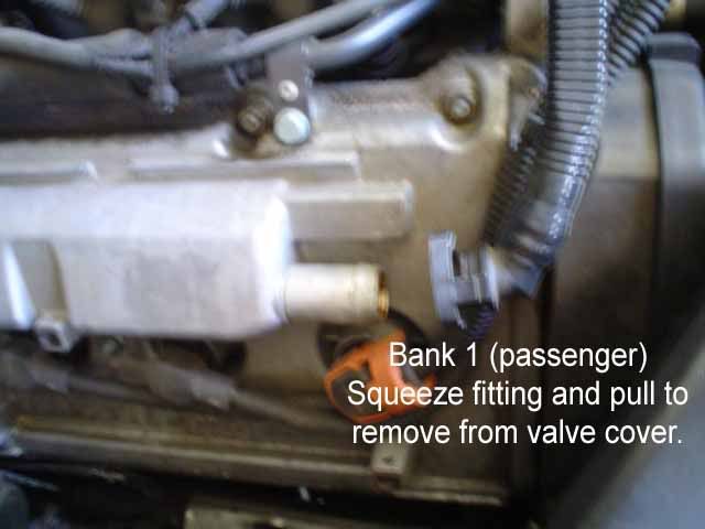

With a COLD engine, the first step is to remove the PCV from the passenger-side valve cover. This is done by squeezing on a black compression ring around the outside of the tube. Then just pull away from the engine. You're done on that side...1 down, three more to do.

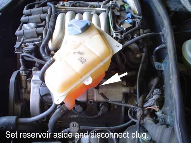

Next, remove the three phillips screws from the coolant reservoir. Remove the coolant sensor connector from the bottom for extra clearance and set the reservoir on top of the engine.
There are three more of those compression rings here, each of them a bit harder than that first one. Just do the best you can, and don't be afraid to cut them apart for better access. You'll be replacing it all anyway, but just be sure you ONLY cut on things that correspond to the part you just bought. There are some other tubes under there of the same material and diameter, but like a vasectomy surgeon, just randomly guessing is not generally a good idea.

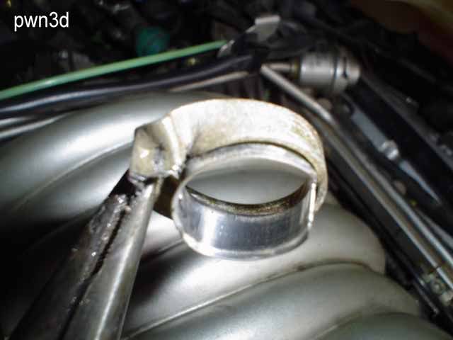

The one additional connection comes straight from the PCV valve itself, and bends up toward the engine in a 90-degree elbow. VW decided that they should make life tough for everyone along the way, so they applied the ubiquitous "single-use hose clamp of doom" here. Just careful tweak it open with your needlenose or wire cutters until you can slide the tube and barb apart and slip the clamp off.

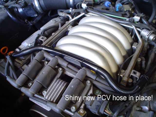

Now the old PCV system has been removed and you can just replace it with the new one. Ideally, try to use a screw-type hose clamp where the one-time clamp was before. However, being a low-pressure system, you can get by with a zip-tie, but it probably won't last very long. And don't forget to put the barbed strap back over the wires/tubing, and be sure to replace the coolant sensor before you screw the coolant reservoir back in. Otherwise you'll get an angry dash icon the next time you start up.

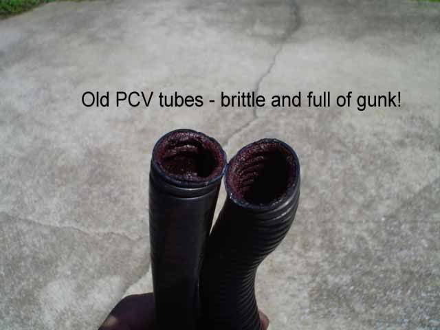

Alrighty! Now can you tell which hose is the new one in this pic?
And while it wasn't completely clogged, who wants hoses that look like this?

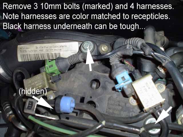

First, identify the vacuum hose plate at the rear of the engine. It sits on top of the intake and throttle body. The original hoses are black and green braided fabric. In this pic, they're all black 3.5mm ID silicone. Remove the three bolts and four wiring harnesses as indicated:
Yes, I know I spelled "receptacles" wrong in the pic above. This was intentional, so as not to intimidate any AudiWorld and AudiZine visitors with the supreme competence and know-how of PassatWorld :D
You may have to pull off a vacuum hose or two at this point, since you want to be able to rotate the vacuum hose plate up on end, allowing you access to the stuff underneath. Now you can see the suction pump.
